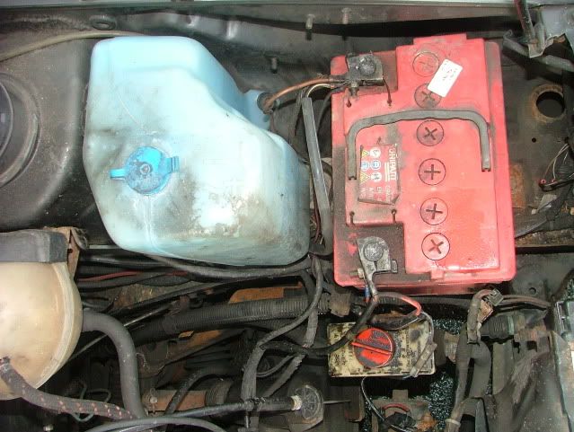

Is it okay to Jetwash a Mk2 8V Gti?
I've had a play with degreaser today as it really is a disaster under the bonnet. I think it just shows u dont give a toss about the car when it looks so crap under there!!!

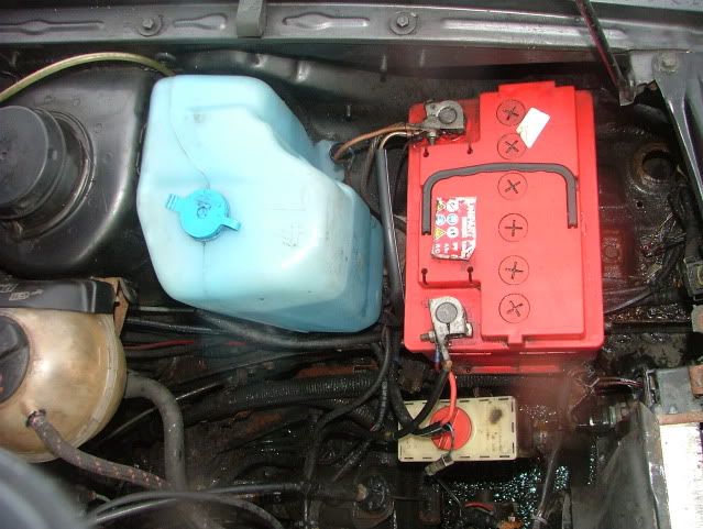

5 mins took one area from this to this:

You can however you have to take care in covering all electrical points with something like cling film.
If it only took 5 mins to get the results above, why not spend a bit more time and do it without a pressure washer, it will be alot safer this way.

You will be amazed at how clean you can get it by hand, then you have just got to try and stay on top of it.
Either go for something like Meguiar's Super Degreaser or even just the Meguiar's APC should do a pretty good job. Both are available in gallon bottle's and when mixed 4:1 they will last forever.

get the engine and bay warm first :wink: then spray your de-greaser/apc on and the oil and crud should come off alot easier.
