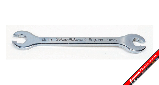

I insist on buying on of these (http://www.comparestoreprices.co.uk/images/sy/sykes-pickavant-brake-pipe-spanner-11mm-x-13mm.jpg), it will make your life MUCH easier.
You may as well replace all the lines up until the bias, then you can just chop the pipe and put a socket over the union - dead easy then.
For the unions I was using, (single) bubble flair was what was needed (http://forums.pelicanparts.com/uploads12/double+vs+bubble+flare1201238131.jpg).

Already got a flare-nut spanner, gotta agree that they put 'normal' spanners to shame!  :smiley:
