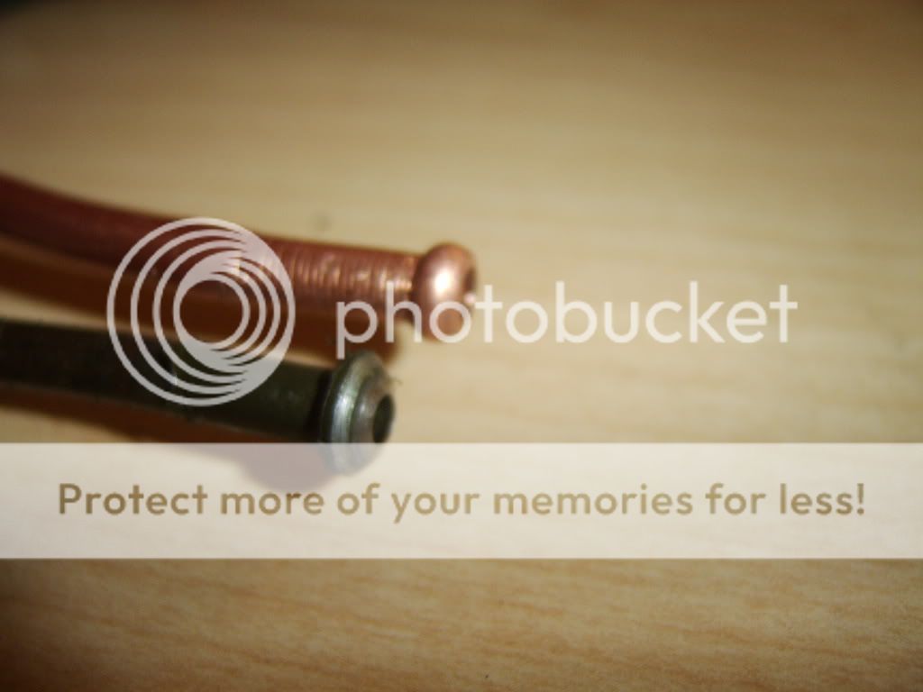

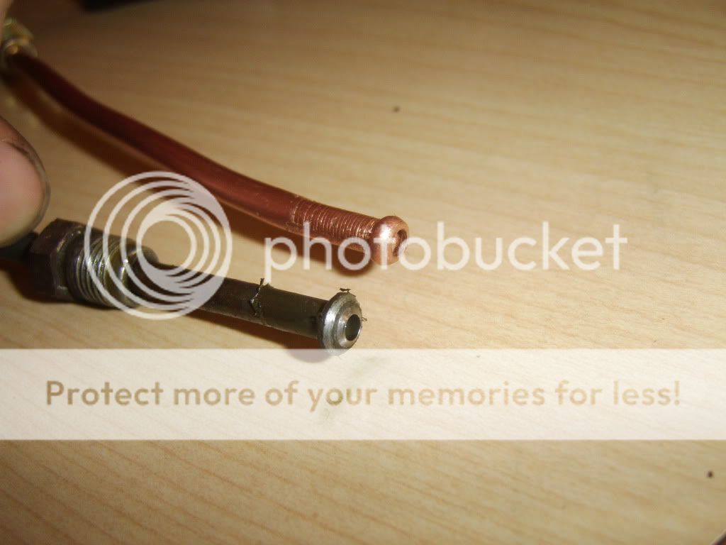

Small query...
The flares my tool are making a slightly different to the flares on my old lines.
It is a double-flaring tool, but I am only doing the first half of the flaring process, so it produces a bubble-like flare.
However, the flare isn't quite the shame shape.  Whereas the original VW ones have a conical tip, my ones have a flatter tip.
I quickly made up a double-flare to check, and it seems to sit inside nicely.   However, there's less contact surface area, so I just want to double-check on here: will it still still give a satisfactory seal???

The male flange you made should be fine, it is better to double flare it, to stop it cracking.
The shape will change when its compressed into the female flange.

Nice one, I was thinking it'll shape itself into the female flange when done-up.
But surely double-flaring it will turn it into a female flange, such that it won't fit into my braided lines/compensator? Or are you just speaking generally?  :huh:

All the guides i have read suggest to do it that way. It won't turn into a female flange, it will just make the male flange stronger.
The best way to do it is to just make loads up, practice is everything.
As you said the male flange will shape itself when compressed into the female flange.

I just (single) bubble flared mine - that's the VW way :)

Cheers Ben (yet again), that's what I've gathered from reading.
http://books.google.co.uk/books?id=5rW-ppyB_ugC&pg=PA91&lpg=PA90&dq=bubble+vs+double+flaring&source=bl&ots=fbpBkjpEup&sig=Eqrz5HmzyBKAPJq3vox5f04NkRE&hl=en&ei=CTP7SqrpOcqe4QbF--2MAQ&sa=X&oi=book_result&ct=result&resnum=6&ved=0CBQQ6AEwBTge#v=onepage&q=&f=false.
Figure 4-15 shows it pretty well.
I would think that cracked flares are more associated with steel lines than copper anyway...
