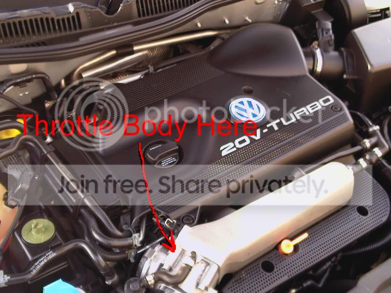

where do i locate the throttle body pal i aint into cars fixin that is would i be able to do it by myself
If you use THIS you will find the answers to your questions HERE

remove four hex head bolts the jubilee clip securing the hose and the small hose at the top of the t/b
