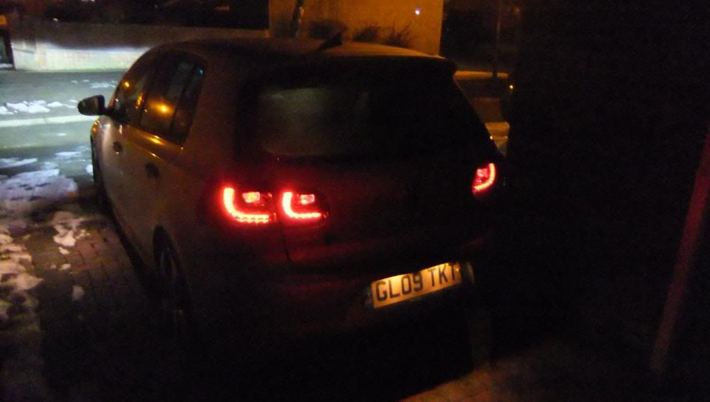

Part no. is 191 972 713 Got mine from Germany from this guy for £35 + postage: http://cgi.ebay.de/Adapter-LED-Heckleuchten-VW-Golf-6-VI-R-GTI_W0QQitemZ160398346282QQcmdZViewItemQQptZAutoteile_Zubeh%C3%B6r?hash=item25587c882a
That part number is just for the connector housing for the pick-up of the power from the original lights and are a couple of quid each at the UK dealers.
It's the repair wires to go into the connectors on the LED lights that make the looms expensive  :angry:
Anyway been a busy day for my Mk6 today.
Firstly had a new development Intake kit installed at ITG, then fitted the OSIR O-Shift DSG Paddles and then at last my Golf R LED tails.
Everything went 100% to plan and the coding was very very easy.
Here's a quick pic of mine are all in and working  :smiley:

And the coding was?
Big favour to ask but any chance of a photo of the brake lights on and the indicators on in daylight and the dark. Im wondering as the indicators are now much smaller how visable they are. (Thats one thing i hate about the mk5 golfs rear lights  :sad: )

And the coding was?
Central Electrics, Byte 18, Hex 00100  :smiley:
