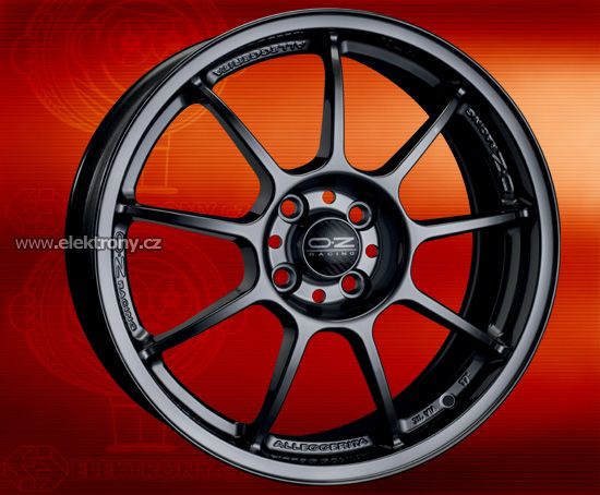

Thanks, but I've gone off the OEM 345mm S3/R32/A3q route - they are just too heavy.  Reducing unsprung mass plays a massive advantage to general handling too - which is why I'm seriously considering ceramics.  :wink:
....Music to my ears! - I've just ordered a set of lightweight OZ Alleggerita 8x18 wheels which weigh approx just over 7 kg compared with 12 kg of my Monza 18's (I don't have the exact weights to hand). It's the handling advantage of turn-in and feedback which has initially driven my choice but now I am learning from this thread discussion that the LeggyRita's open spoke design will also benefit my brakes - Yippee!
Sexy wheels Red, but I'd recommend ordering a 'spare' too.  When you make alloys that light, there has to be compromises to get the weight that low - and if you happen to hit a pot hole at a particularly unlucky angle (or speed  :lipsrsealed:), then they have a tendancey to fold like origami.  The original Audi RS4 (or was it 6) was plagued with this problem.
