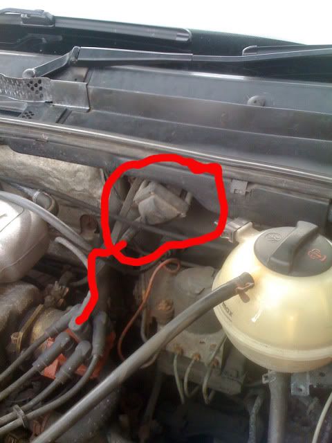

While trying this, i think i turned the engine over about 3/4 times and a smal puff of smoke came out of this :
Could this be my problem?
What is this?
As you can see there's a wire running from the distributor cap.
This is rattling my head

That would be your coil pack.

As above coil pack.

The smoke aint coming out of the coilpack its self, its the bit with the red circle round it?

That would be your coil pack fella. as stated by Wayne & GTiAdam :smiley:
Common problem,
Check out the Mk3 Maintenance section loads of useful info on there  :wink:
