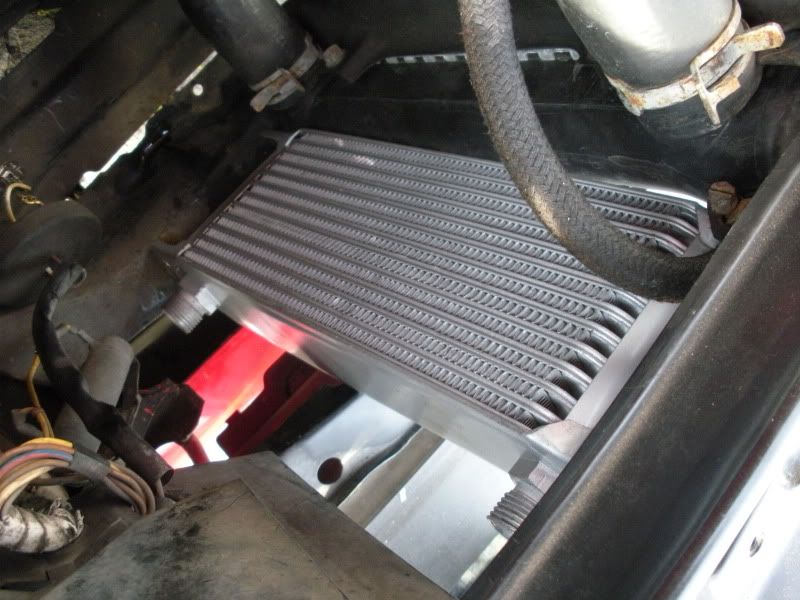

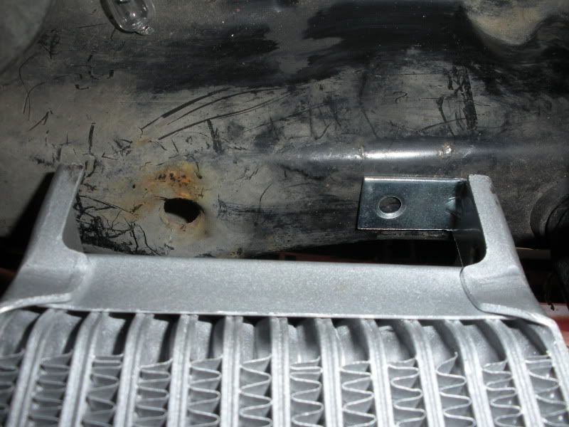

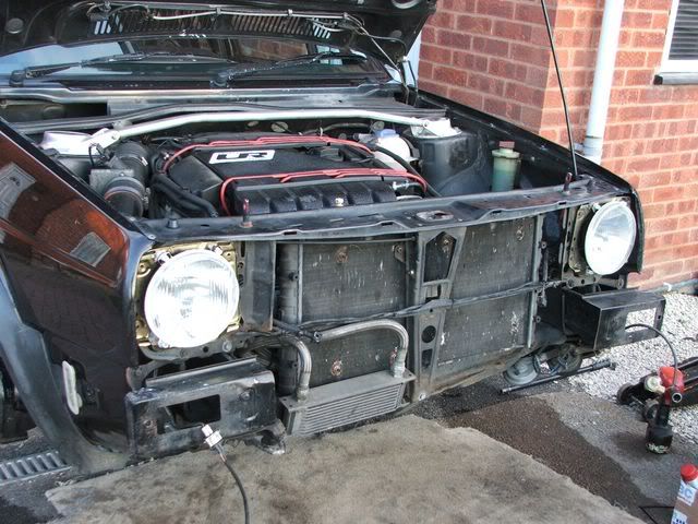

Ok so hopefully this afternoon was the last time I'll have to mock this thing up - could strip the front down with my eyes closed, I've done it so many times  :laugh:
I've decided to mount it vertically in the end as everywhere else seemed to cause problems - bumper recess the pipework was too short my about 10cm (pain in the arse).

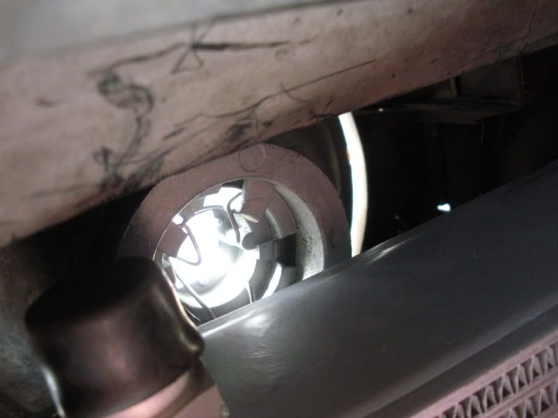

I think there should be enough air flow around the spotlamp now the trim around the rad has been removed. However, I've noticed the cooler does touch the back of the lamp i.e the bulb cover. Is this going to be a problem? I don't want it to melt  :grin:
 So, this is how it's looking now:

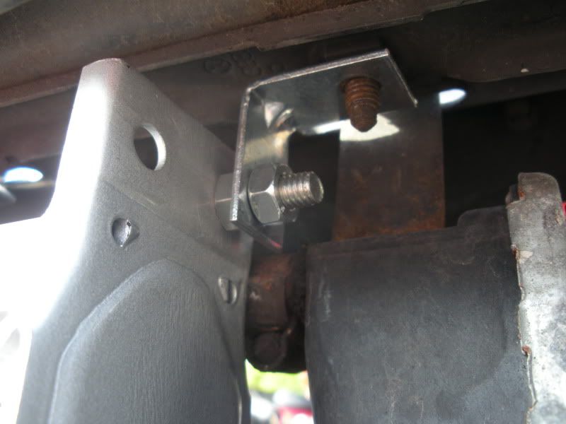

Will be held in with 2 bolts in the slam panel and two in the front cross member. Pics are a rough mock up. If you have any advice or can spot any probs please shout  :smiley:
