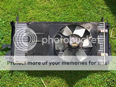

Just spied the below on ebay, advertised as a 16v rad and fan but going on what ive found out it seems to be the wider 8v rad with the 16v fan setup.
Are the brackets on the right the kind of thing ill need to be making?

yeah basically
that looks like a diesel rad with a 8v fan to me, its mahoosive!

Great, those brackets seem nice and simple  :grin:
That rad does look a bit of a monster don't it!!
