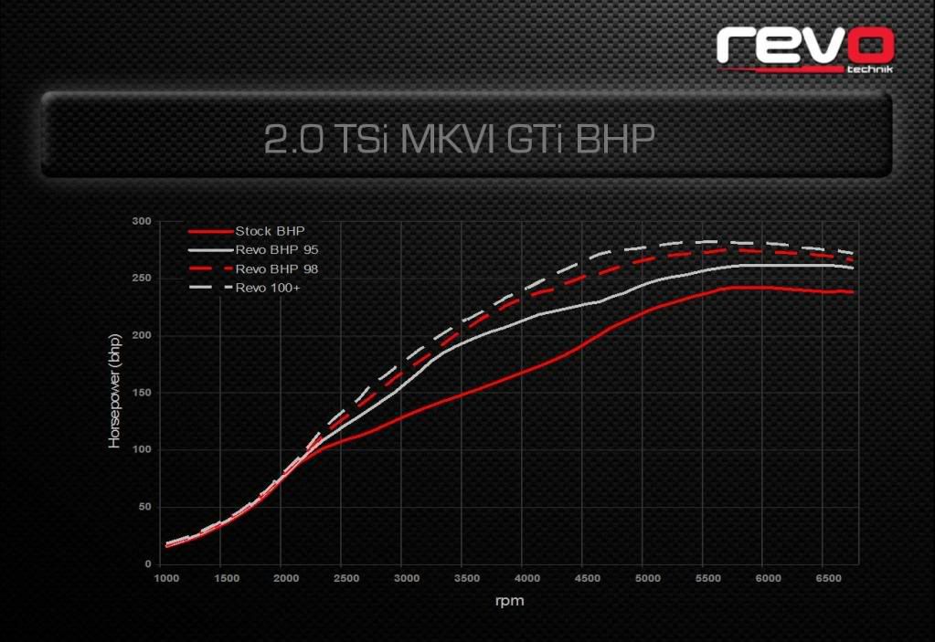

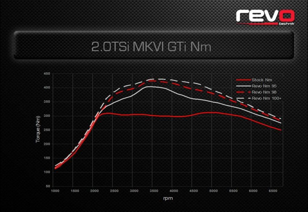

well...... Gossa should now be enjoying the mk6 software :)
so you might like to see the results....
 :cool:
(mods i hope you don't mind!)

Thats impressive. Look at the extra torques your getting, over a 1/3 more from 2500 revs through to 5000.
Why is the stock BHP hitting almost 250 ?
And how much does this cost ?

So that about 275BHP?? Is yours a manual or a DSG? and does it make a big difference to getting it remapped?

240BHP stock ???? Eh ????

stock the car did 235 BHP, all turbo VAG vehicles will do over quoted numbers on a chassis dynos..... the difference is represented either way!
the cost of the software is the same as all our other 2.0T software :)

the car we dyno'd was manual but we have software for both DSG and manual cars! :) peak power will be the same as you can see the car makes peak power in both cases before the DSG shift point
