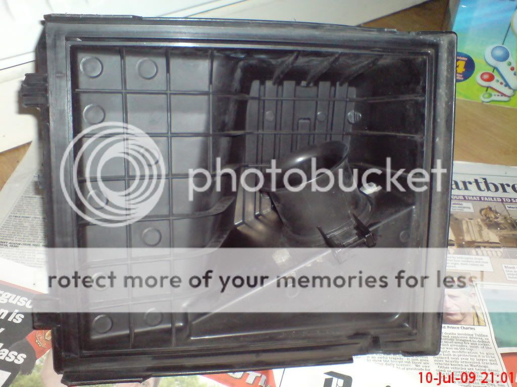

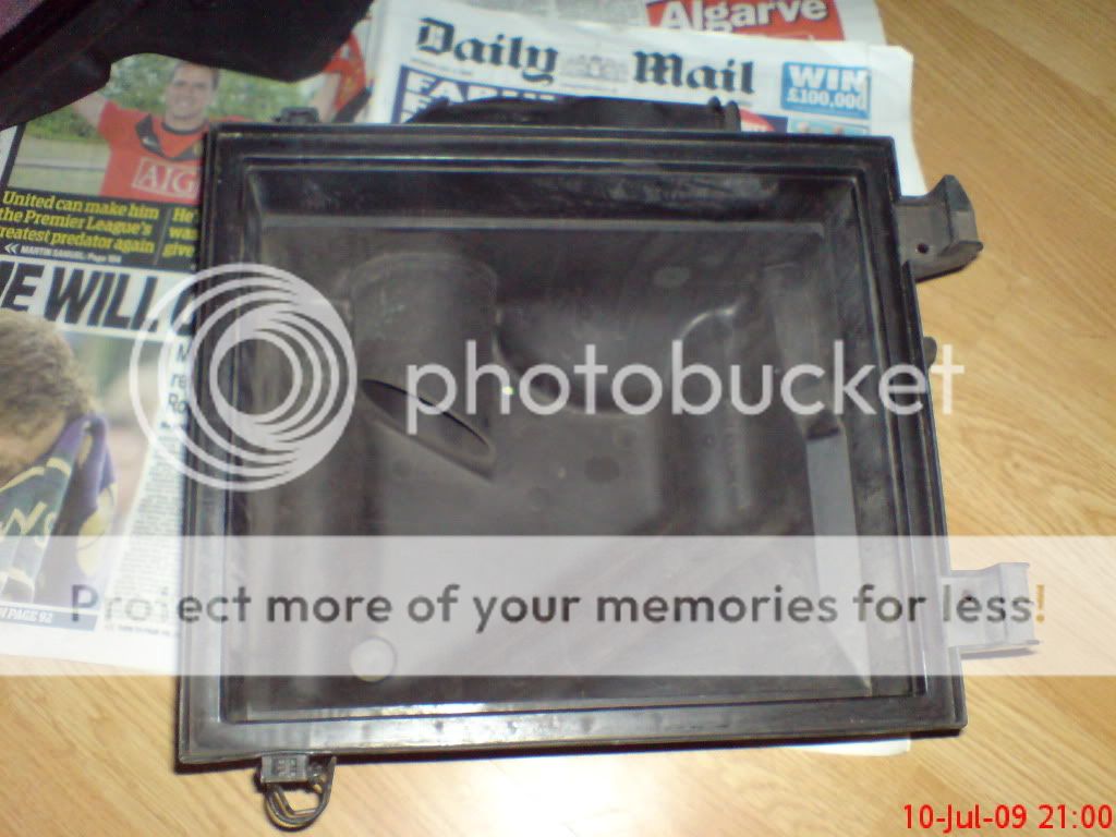

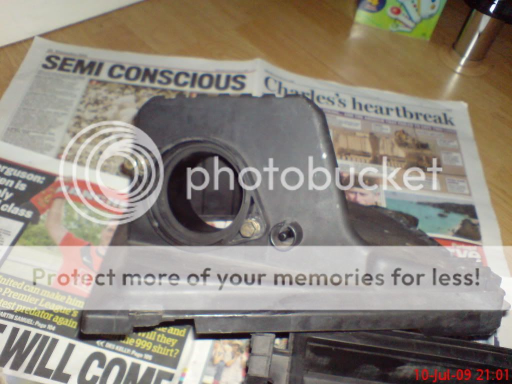

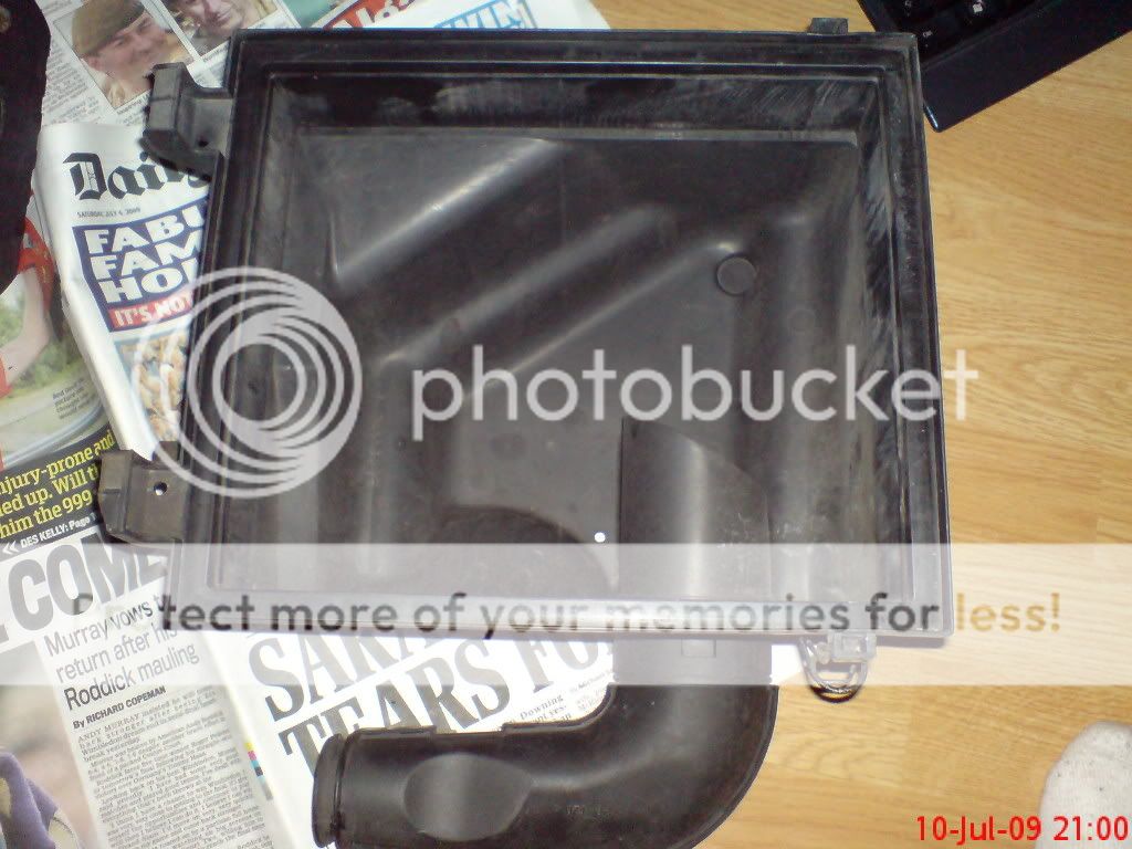

here' the pictures of my air box.... - 1.9TDi AHU
Offline Ess_Three
  • Posts: 3,123
Doesn't look to be too much wrong with that...
I'd leave the lid alone as there is already a nice smooth duct to get the air out.
For the base, maybe just work out a way of getting more air in. Bigger inlet?
Get rid of the angled inlet with the restriction at the inlet...and get a bigger inlet in there.
That's about all you can do. Seems to be a pretty good design as standard.

is it worth cutting the tubes away from the inside so the air goes straight in ie; not channelled
Offline Ess_Three
  • Posts: 3,123
No, I wouldn't.
Fine it it's a restriction...but that looks to be parallel, with a flared end...which should air airflow out of the airbox.
I'd leave it, personally.
Look at the inlet though...try to get a bigger, coil air feed in there...from as close to the front of the car as you can.
