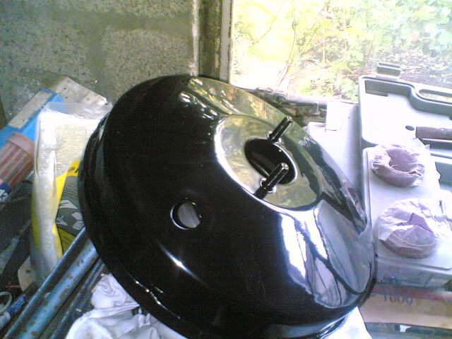

One I did this weekend.
And Servo.
You should bleed the system as a precaution anway. Buy a litre of Dot4, as half will fill the res bottle and a bit more will clean the old fluid out.
But you could get away with not bleeding the system if you don't clean the crap under the grommets and just put the res bottle back on once you've finnished messing with the brake pipe.

Wow the cylinder and servo look great!
Will see what the situ is like when i get the res off - if i do clean the crap from the grommets, where you say i will need to bleed the system,  does that involve going around the wheels and bleeding each caliper valve as i havent done it before?  :undecided:

Bomp...that master cylinder looks mint!
