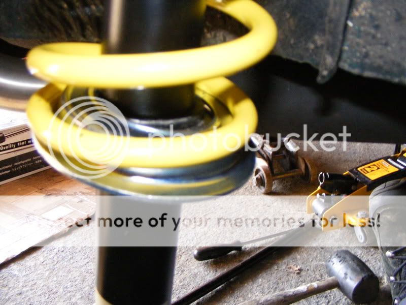

Stripped the struts apart transfer over the spacers etc and the spring doesnt sit on the lower cap  :rolleyes:
Thought it would seat when we built them up  :huh:
but alas no - the spring is slopping around when the struts is built n fitted
so on the phone to  shop and after a lot of  to n fro-ing they want more piccies
so
old spring fits onto the new cap, and the strut
but the new spring doesnt
and it didnt fit the old strut either  :huh:
So a load of mesurements taken and piccies emailed off - and we ground to an abrupt halt  :cry:
Now i now lowering springs of 35mm drop be a tad shorter but  :shocked:
Guy is now awaiting a call to see what they say, but if th spring dont fit the lower plate, and doesnt fit the strut even when fitted, it dont take much working out  :lipsrsealed:
