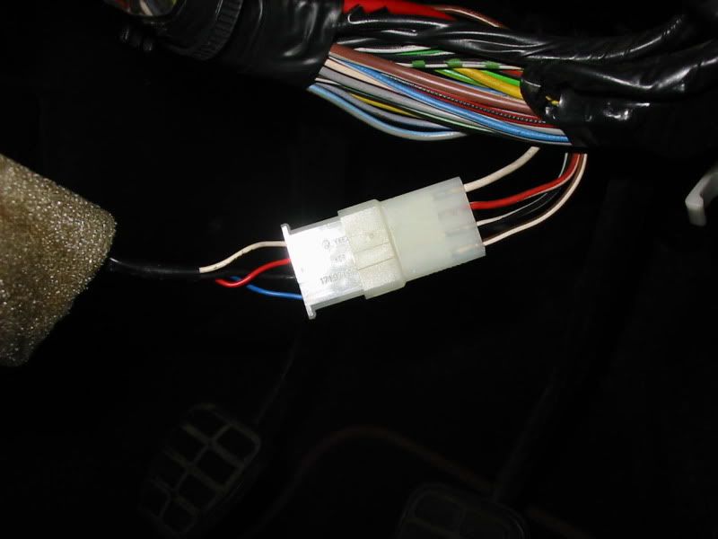

Hi, having driven another mk2 gti today I realise that my MFA stalk is not working properly. All the functions work OK but to scroll them you have to push the sliding switch to 0, the button on the end does nothing at all and I know now this is supposed to scroll through the functions? I know there's a clip connector in the column but iirc this can only go together one way? Any ideas where the problem might be? Thanks J

right should deffo have that kind of switch on it then! my guess is the pins/wire snapped/came adrift in the past and a po put them back in the wrong order!  iirc the wire colours both sides if the mfa stalk plug match so it should just be a case of following them back as far as you can to check they all match :)

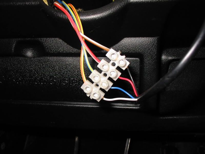

WTF is going on here then!   :laugh:
Wire colours are not the same, do you think a pre 89 MFA stalk has been botched in?
I thought I'd be clever and pull my son's '89 apart..........bu**er.........the wiring has different colours to my '91 job...... :undecided:
Can anyone help me match the wires in the first pic correctly?  Thanks. J

ok! looking at diagrams and what you said, I recon you need to swap the red/white and yelow/red over :)
edit: hmm, maybe not, just had a look at pre/post diagrams after I see the pre-90 one on your pic is different colours. Not so easy, I think it needs to be:
blue - brown/white
white - red/white
red - blue/yellow
black - red/yellow
My larger worry is why is there a mix of pre/post 90 here, have the stalks been bodged as weell, where is the hazard switch? any other nasty lookign wiring underneath the cowling to stalks?
Could just be he has swapped a pre-90 mfa button end onto a post-90 stalk, you can actually pop the tips off them
