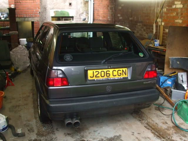

my mk2 has a problem, the passenger side rear wheel rubs on the plastic arch when i have people in the back, the car is lowered 40mm on shocks and springs and the wheels are 15` bbs ra`s.
im not sure why it does this and it only does it on the passenger side of the rear plastic arch.
any ideas?

it looks as though the drivers side rear wheel has some camber on it, hard to see from this pic i know:
then the passenger side looks fine:
but its the passenger side thats rubbing.
could it be the geometery as the prev owner did the shocks and springs himself.
i have had a good look over the car and i cant see any welding or accident damage?
im really confused about this and i need it fixing as im doing a long trip in it soon and the car is going to be full of people.

Rear camber is only adjustable with shims etc, to be honest most Golfs seem to only rub one side my mk3 did, I was told it is to do with how they are built and where the beam sits etc.
