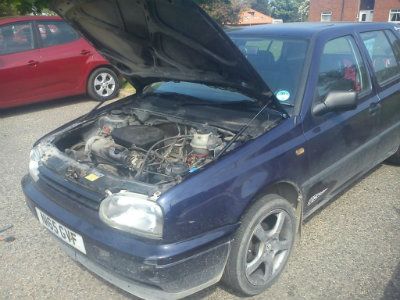

Went to Milber Salvage & Spares today and bought some tailgate lifters to do this mod  :smiley:
I'm super happy with the outcome! For anyone who is interested though, Polo 6N Tailgate lifters don't work because they are to short. However I managed to find a set from a Seat Ibiza that worked a treat! I had to use a combination of both the cars fitting nuts though.
