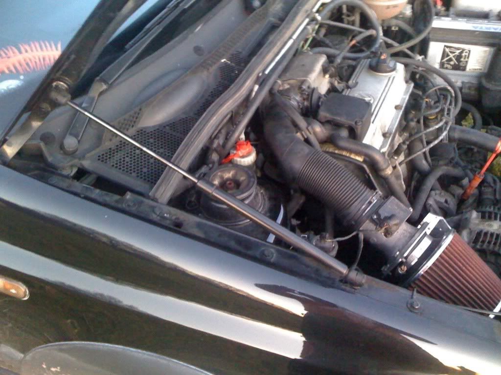

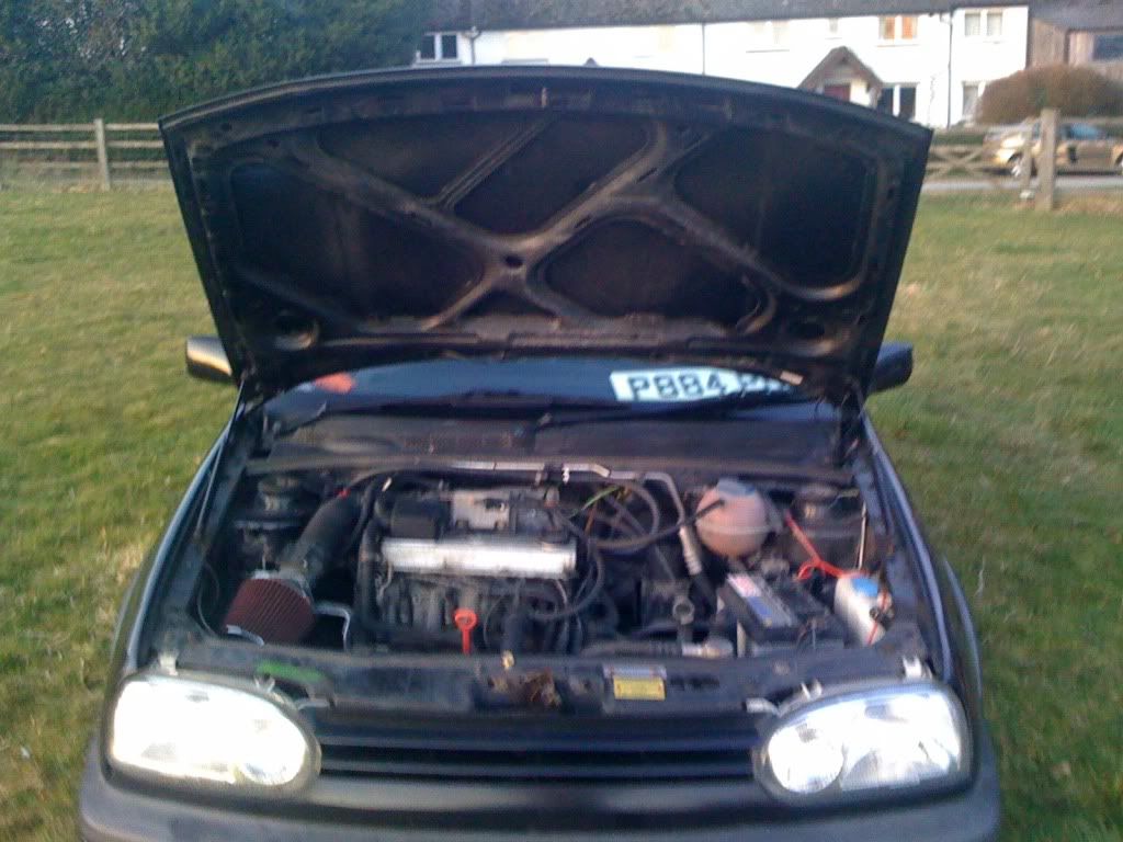

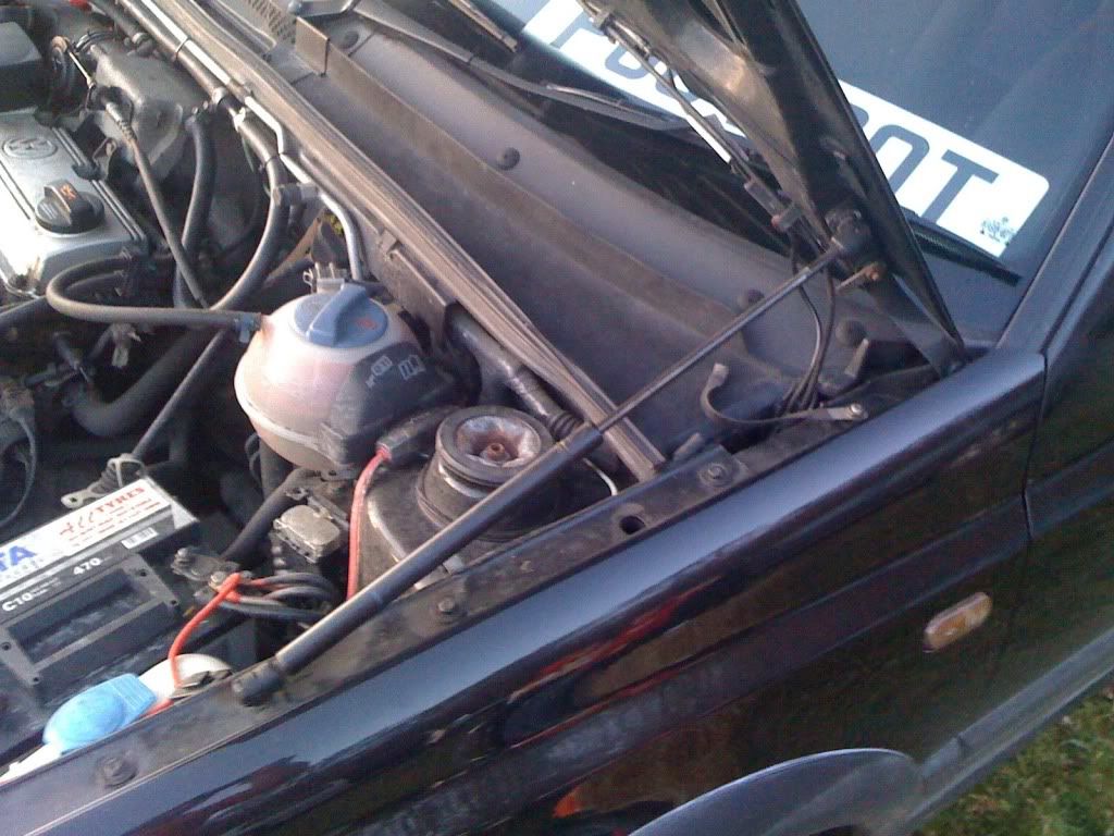

This is one of my favorite things i have done to my car - very easy to do!
Couple of pics for you all
And my best mod - i have a Doug-charger - no extra power just a lot of noise!!!
