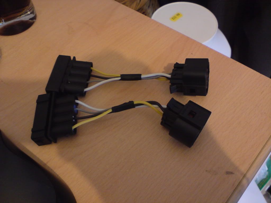

I'm guessing the plugs you have are the ones on the right but the Hellas have the plugs on the left?
In which case, these would be no good, and they don't do them the other way around, so the only thing you can do (if you don't wanna chop your current loom) is replace the loom with another one. It's easy enough to change, just unplug the headlights, indicators, fog lights and horn, then if you look above the radiator, attatched to the slam panel is the wiring connector block, twist that and pull it apart, and then trace all the wires back, disconnecting them from all the clips etc. Refitting is reversal of removal, lol.

Now this is funny and embarrassing all at the same time  :laugh:  :embarassed:
I took another look this morning to see if i fancied chopping the loom and found that the hellas have a convertor cable like the ones above in VR6-Joe's post already plugged into them, so in other words they have obviously come out of an old car and have the convertors plugged into the lights for the old style wiring.
All i had to do was unplug the convertors and then plug my harness in  :grin:  :grin:
