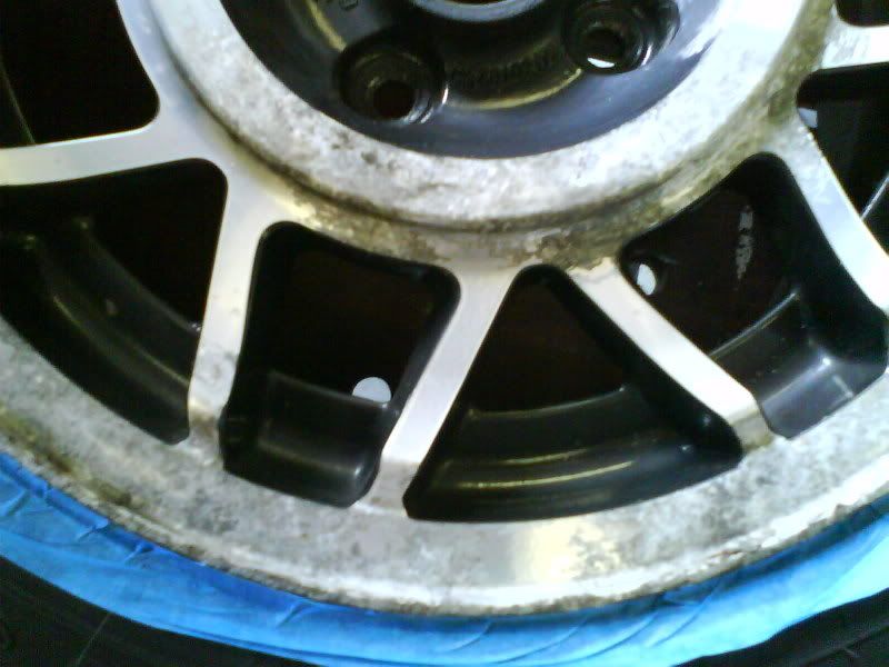

if they are knackered then use fine grade wet & dry on them... follow that up with a good going over with autosol and then follow that up with a few goings over with belgom alu (it has wax in it) then further protect it with some wax of your choosing

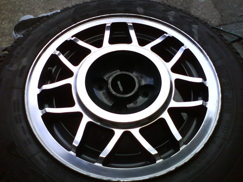

Belgom alu is great, refurbed some wheels on a mates Scirocco and used that as the final wax/sealant....
Before;
After;

Excellent work on them alloys

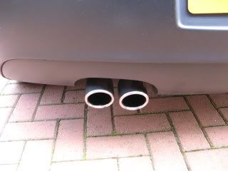

Well I`ve jusrt had a go with some autosol and some fine grade wire wool, not perfect but they will do for now until I`ve got a bit more time:
