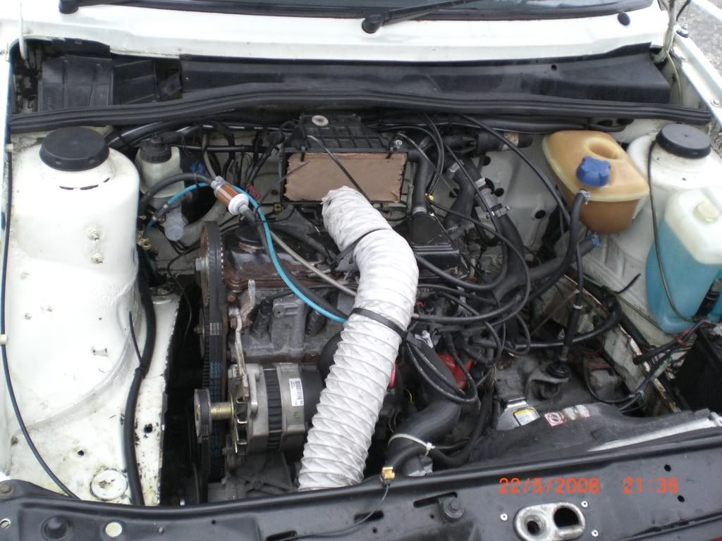

on mine the trumpet inside the box just unclipped.. but mines the slightly weird early bosch maf i also cut a section out from the side closest the wing and used piper x panel..

on my old mk2 i got a pair of tights (mine obviously :tongue:) and the mesh from an instant bbq and i made a nice little filter, and i removed the front half of the airbox. (mk2 1.6 carb) it sounded like the devil but it did loose performance due to heatsoak.
