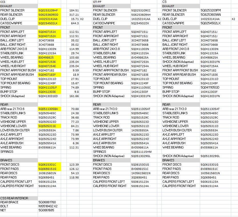

^^I here you
This is the part number of different parts, the lower front arms weren't different but the rear bushes in the front arms have a smaller void, so that was the reason for the part number change. The front hubs were different and that required different bearings but its only VAQ parts bin stuff.
I have the discs and pads as they are on the TCR too. I also fitted the rear ARB to my old GTi PP back in 2016-17

Is there a definitive list anywhere of all the differences between a GTI PP and a Clubsport S? Not cosmetic, but performance-wise. I assume the CSS has the R engine/turbo. Are there suspension differences? Obviously the latter is a bit lighter with no rear seats. What else would be needed to do a CSS-style build on a PP?
I think there are some threads elsewhere on the specific part numbers but the launch press release gives a decent walk through.
