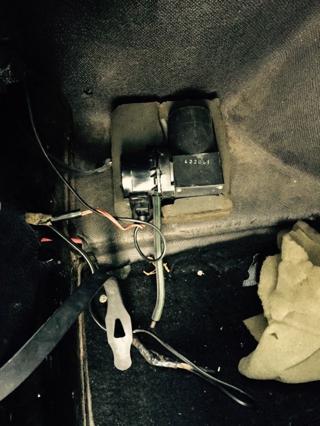

This black/green air tide has become disconnected. Where does it connect back to so my central locking will start working again?

surely the pipe it fell off is local to the pump ? i would think in where the cables in your picture go

There's a t-piece connector for the vac pipes about the distance of that pipe away hidden in the rear panel, think it's come off that.
Yeah there is, a little green one IIRC. I recently reconnected mine.

The T-connector had popped off. I have now reconnected the vaccum pipes and the central locking is working.

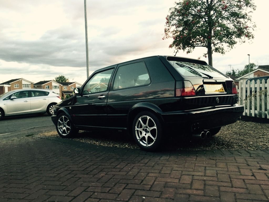

Here's a photograph taken from last night, the previous owner had a poor taste in wheel selection (Why would you ever take the original BBS RA's off in exchange for these?) - I have every intention of putting a set of BBS RM's on her.  :wink:
