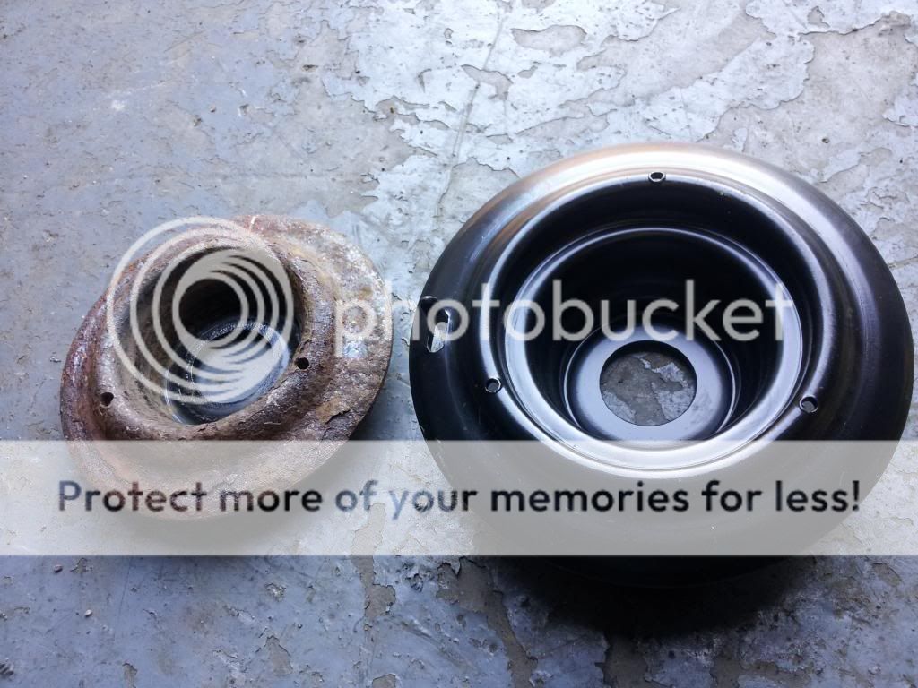

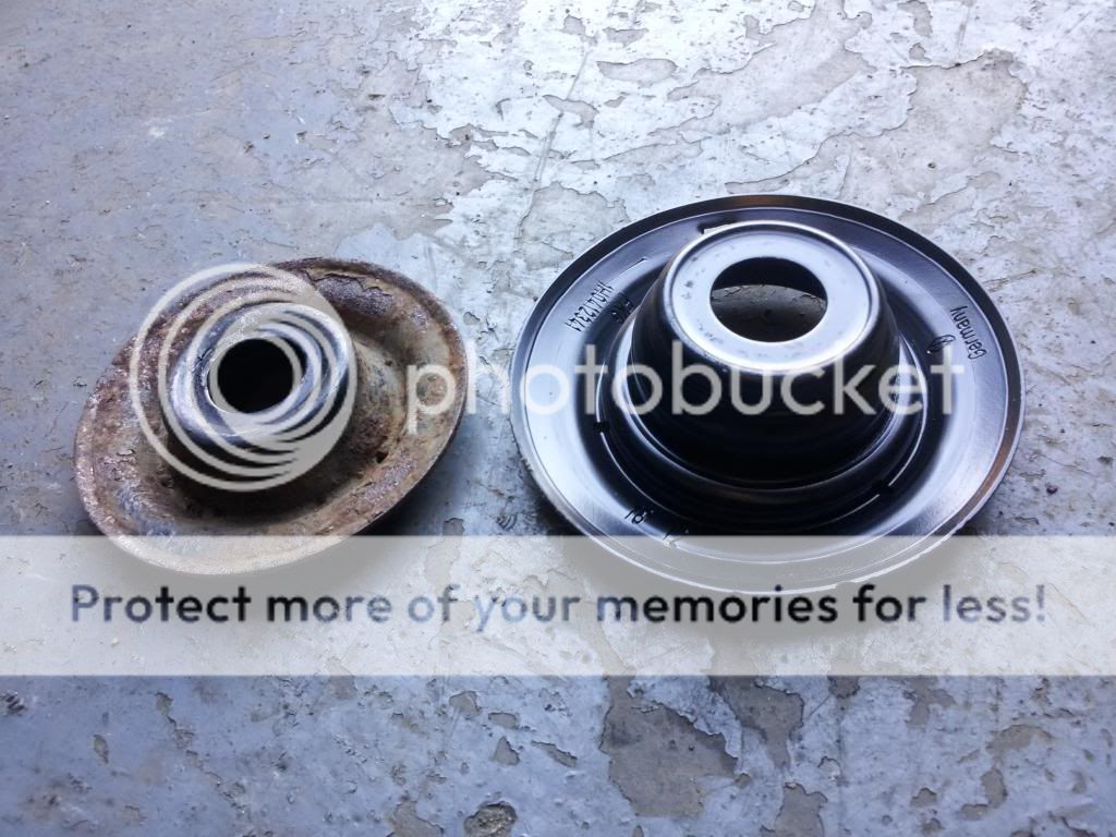

I think I found the right part!
It was part 1H0412341. Were about £20 inc VAT each from main dealer (not exactly cheap!)
It is taller than the original but not by much. Fits top of spring and top mount bearing perfect and is same style.

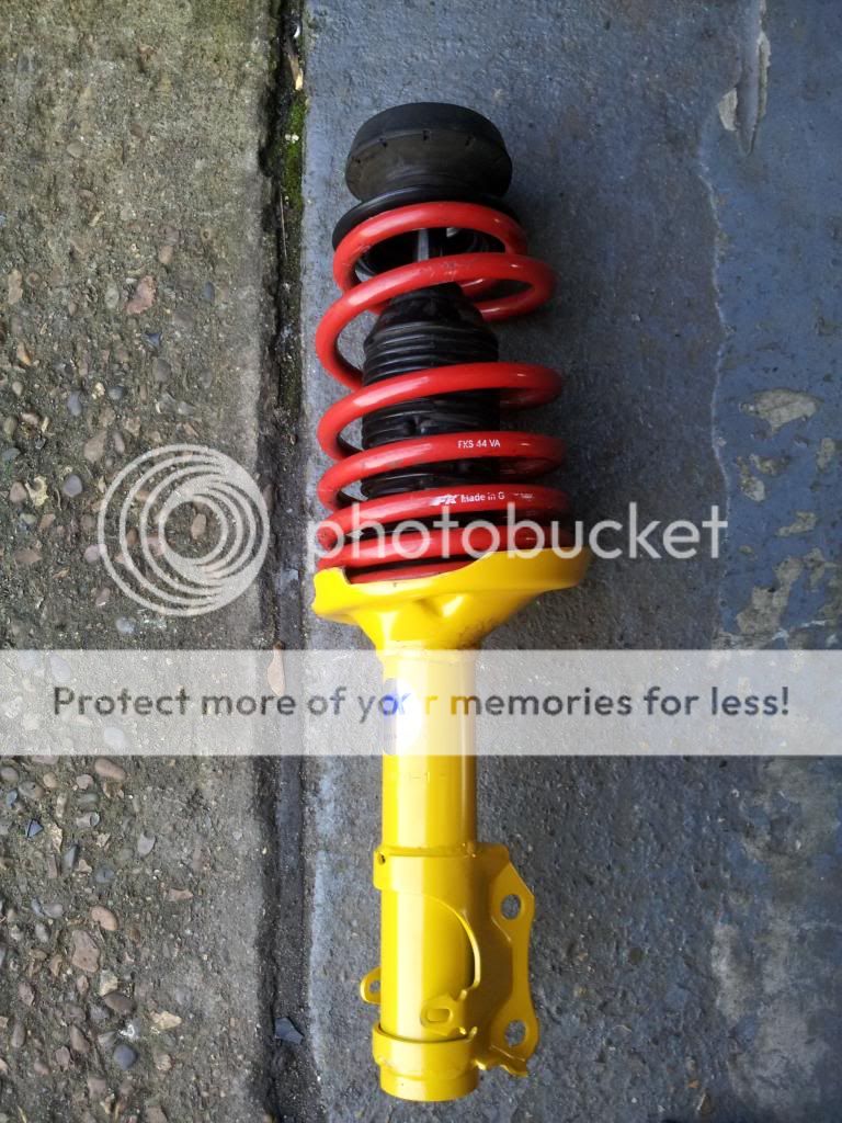

Here's how they compare to original spring plates and how they look fitted to:
FK FKZZVW10 sports dampers
FK FKVW075 40mm lowering springs
(www.carparts-tuning.co.uk/‎)
In hindsight i would've tried to find a lowering spring set that fits the later smaller MK3 Golf spring plates (??) or a cheap set of coilovers but hey this is where i'm at.
How it looked on my car:
