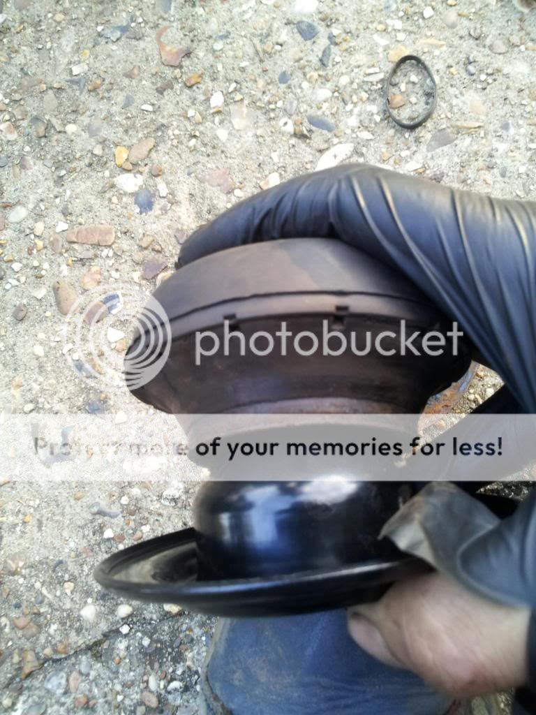

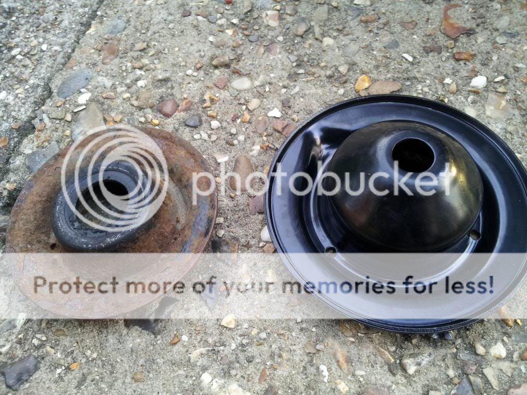

25 October 2013, 18:01 »
No they weren't the right part and don't fit the top mounts very well at all
Diameter is about right though.
Here's how they compare:
Anyone have any ideas what is the correct part i need?

Aren't there two types of top mount rubbers as well so youll need matching ones?

I am in exactly the same position and not happy,
there's a mention of different spring plates on FK's info but theres no mention of what you need to buy,
http://www.carparts-tuning.co.uk/Suspension-Tuning/Lowering-springs/Lowering-springs-High-Tec-fit-for-VW-Corrado-16V-G60-VR6-53i.html?force_sid=320176377faf5b24bbddd1d34f200aec&listtype=search&searchparam=fkvw051
-For vehicles from Yr 10/93 were instd with different VW spring plate on the front axle. For vehicles with a small
-for Yr: 1989
-1996
I think I(we) need these
http://www.carparts-tuning.co.uk/Promotion-sale-items/SALE/Lowering-spring-cap-fit-for-VW-Golf-3-Typ-1HXO-1H-1E-GTI-16V-VR6-bis-07-93-Corrad.html
It keeps the later "floating" spring plate design, only problem is it will lower the front by (I guess) 10mm or so,
but looking at the stock early mk3 to late mk3 plates it looks like the early ones will raise it by 20mm or so.
