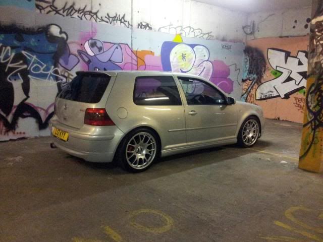

new ecw 14lbs lightweight sm flywheel and vr6 sachs clutch fitted.
picks up better higher rev range and up hills.
found harder selection into gear was the pinion that goes through a bush as part of the leaver that connects from the box to the gear selector cables. cleaned up the pin on the wire wool and greased it up.

looking good dude, you going to any shows??
