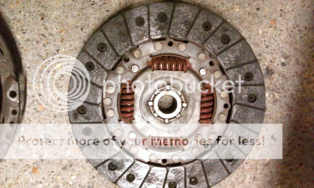

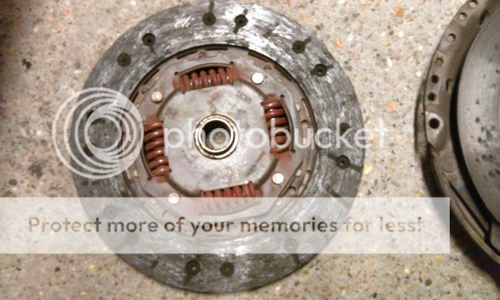

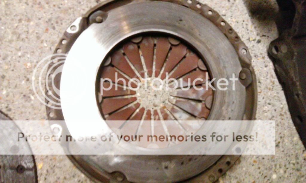

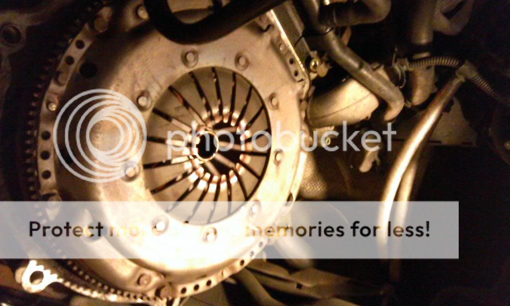

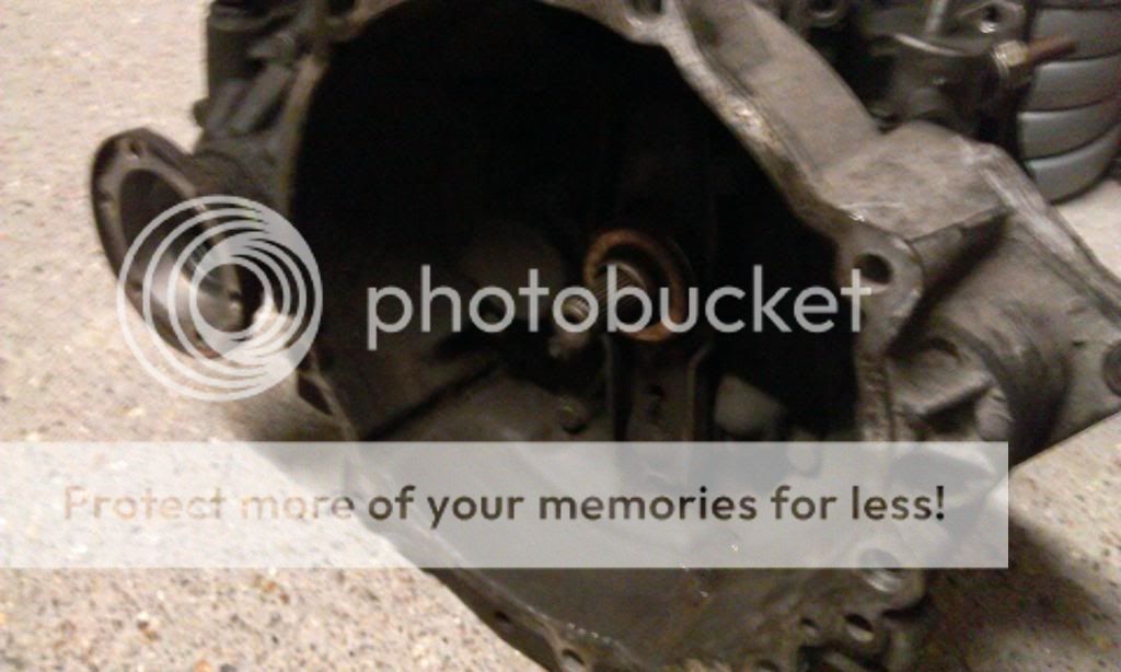

Got the gearbox out earlier after fighting it out from the car,rear crank and input shaft seals all dry so good start,friction plate and release bearing are f$$$$d coverplate seen better days to and scored up so all that lots been binned  :grin: clean up and will get it re-assembled tomorrow
