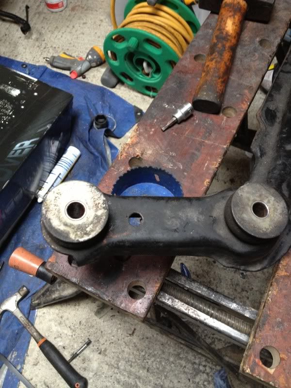

Got some new poly bushes to put in the front cross member
How do I remove these metal plates to push the original bushes out?
1997 16V
VW BUSH

« Reply #1 on: 02 August 2013, 21:09 »
Click on the pic to enlarge.
Get choppy with a hacsaw and order the new washer housing bolts etc from VW

surely you don't have to chop them up???
VW BUSH
Re: Cross member bush change
« Reply #3 on: 02 August 2013, 22:59 »
no but its damn quick with new bits and an angle grinder :grin:

« Reply #4 on: 02 August 2013, 23:57 »
So from the diagram , if I snip through no.4 and re-order that , I should be good right ?

« Reply #5 on: 03 August 2013, 08:38 »
Get hacking,  replacements aren't going cost much at all and will save you  wasting ttime on trying to separate the old ones without damaging them.

« Reply #6 on: 03 August 2013, 14:16 »
but some people have lots of time but little money :huh:

« Reply #7 on: 04 August 2013, 08:33 »
So you guys are saying cut through the sleeve protruding from #3, then buy#3and #4 and refit with the replacement poly bush?

« Reply #8 on: 05 August 2013, 00:14 »
You could heat item 4 with a blow torch to expand it but it'll be a bit messy with the rubber bush likely to catch fire
