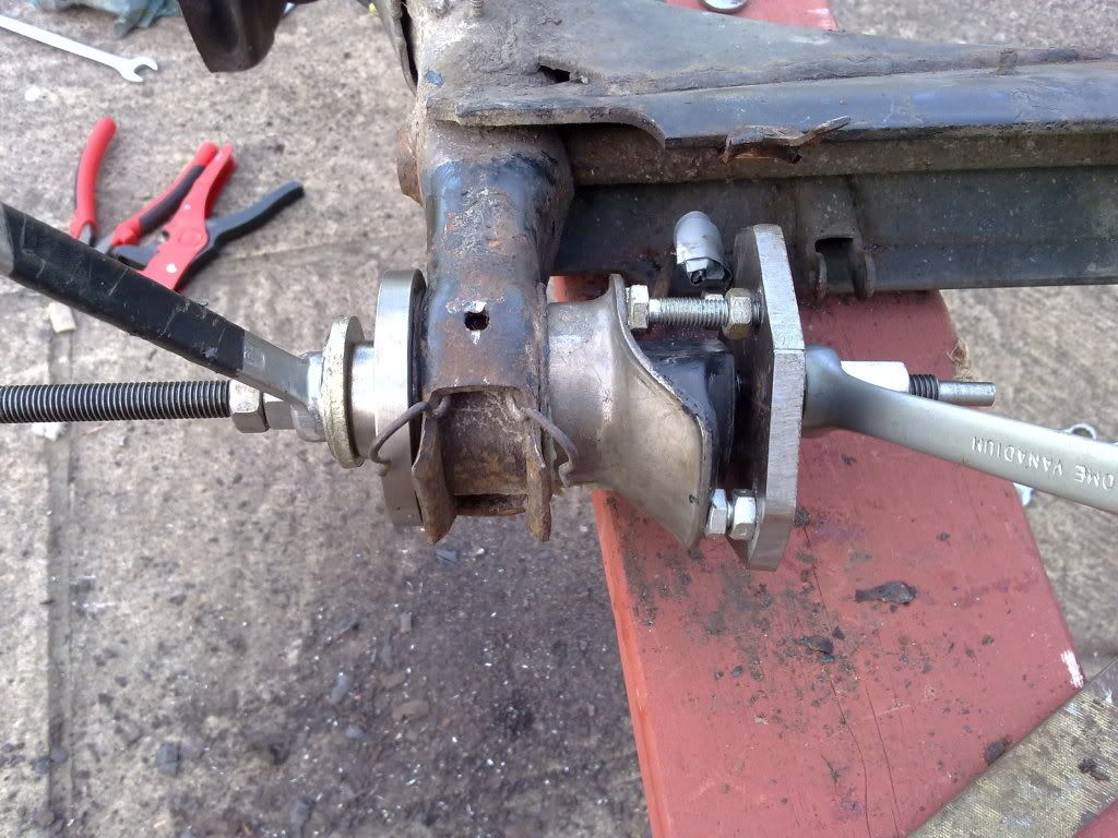

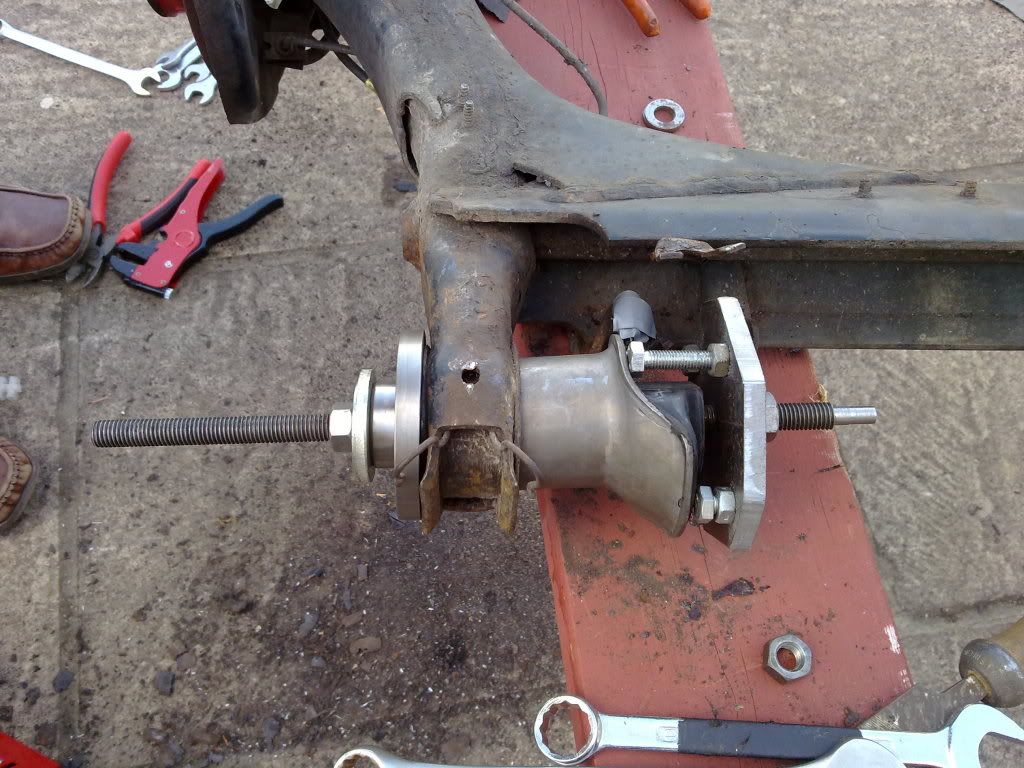

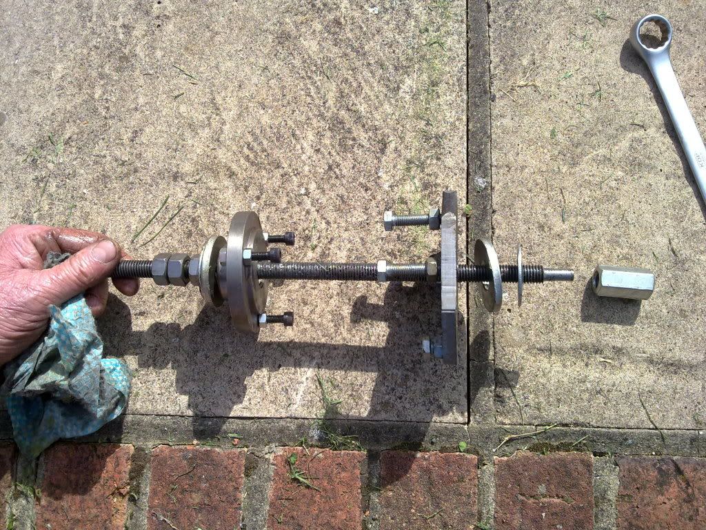

Here is the tool I made, very simple yet effective :D
If anyone wants a similar one im sure i can make one up for you for a small charge :D :wink:
