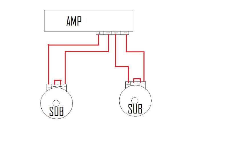

I have them like this at the min, but the amp is a four channel one, and im using the channels bridged...
Its only a low power JBL one, 2 x 235 @ 2ohms (bridged) i think, looking to buy new amp soon as i know im really underpowering these, just interested what sort of amp would give me maximum effect with these.
Also, where they 300rms, does that mean per coil or overall?
Wiring at the min;

you have wired it exactly right
and the power is over both the coils so each sub is 300 rms
