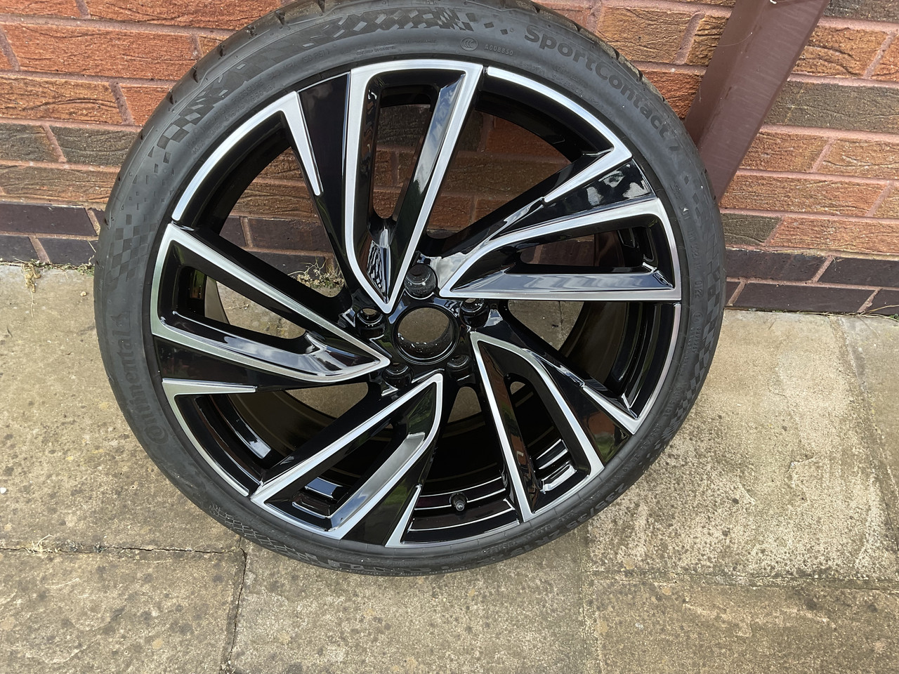

Today was a good day to put my flaking Adelaide rim in a new layer of clearcoat
