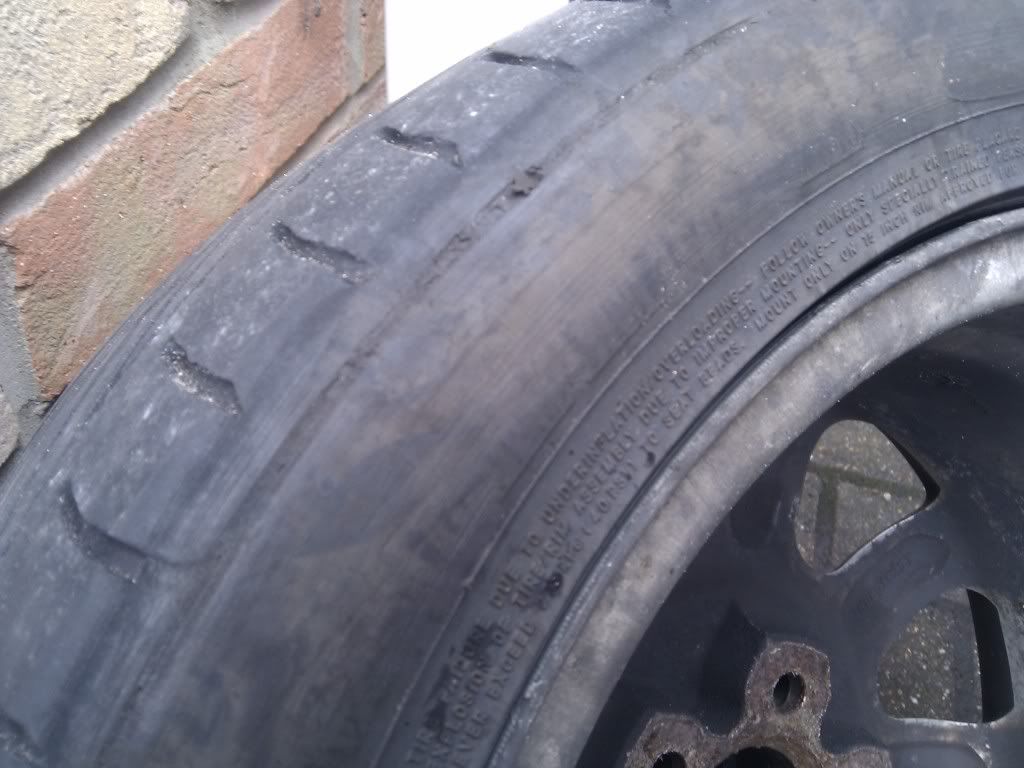

Found this today
Seems to be rubbing on the coilovers.
However, I had a look with the wheel mounted and on full lock both ways, and it's got plenty of clearance....Strange....
I think I need some spacers though  :undecided:

The tyre is moving under load  :smiley: hence not catching all the time.

5mm spacers should be adequate.
Explainable then.
Yup, will keep standard bolts by using them too won't I?
Should I be looking at hubcentric ones right?

I ran 5mm flat spacers (non hubcentric) with standard bolts on the MK4 with no problems at all.
Cool stuff. Will get hunting  :smiley:

Are you running 195/50/15's if so very strange as mine were nowhere close.
Might be worth checking your camber.
The problems started just after I stick the 16v brakes on  :undecided:

Long shot, but is the wheel bearing ok, I would check that as a urgent 1st step.
Wheel bearing is fine, I had a look in there today. The only thing I can think of, is the 16v disc allows the wheel to be closer to the strut, but then again plenty of 16v's running 195 tyres.
