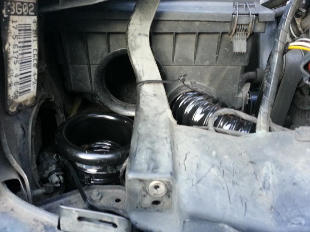

I noticed you've done a fair bit of airbox experimentation, my lower will be similar to yours.. i have a couple of questions though if you could help..
1.is it worth smoothing the upper part of the airbox
2.whats better for the opening? a single large opening or two smaller openings? I am thinking the airflow will be more directional with a single opening?
cheers
Offline Khare
  • Posts: 7,626
  • The bear that khares
Re: khare's mk3 GTI...16v!
« Reply #716 on: 18 March 2013, 14:26 »

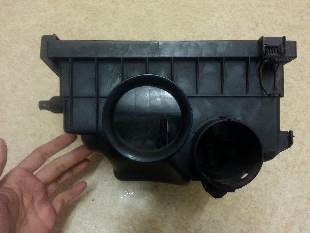

Definitely smooth the top of the airbox as well. Where the opening that connects to the intake pipe is, round that off so it's not a sharp edge if you know what I mean. Regarding the openings, I have two on mine.
Top half with the rounded lip
Since that was taken I've pulled the smaller air feed out of the hole and aimed it in that direction rather than actually being in the airbox, and I've cut away the bit from the slam panel that obstructs the bigger hole.
Offline Len
  • Posts: 16,292
« Reply #717 on: 18 March 2013, 14:29 »
That inside only shows one hole? :huh:
www.sas.org.uk
www.the-ace.org.uk
Offline Khare
  • Posts: 7,626
« Reply #718 on: 18 March 2013, 22:38 »
That's because that's the top half Len  :grin:
