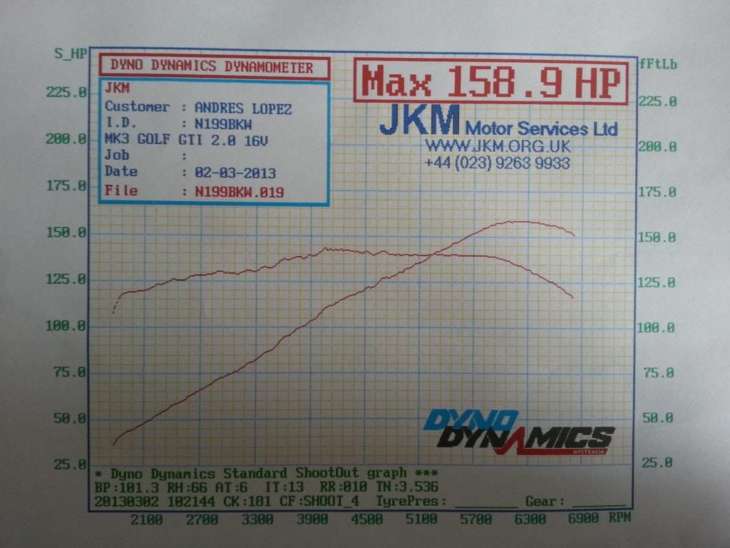

Down 6hp apparently
However I'm not sure about this. A hell of a lot of cars seemed to drop power as opposed to runs at the same dyno weeks ago/last month. I'm convinced there was something wrong with the calibration this time round. I can feel when an improvement of 1 or 2hp happens and I certainly can't feel a 6hp loss. Graph is identical to last month's 165hp run, just notched down at 158hp so I'm not sure....

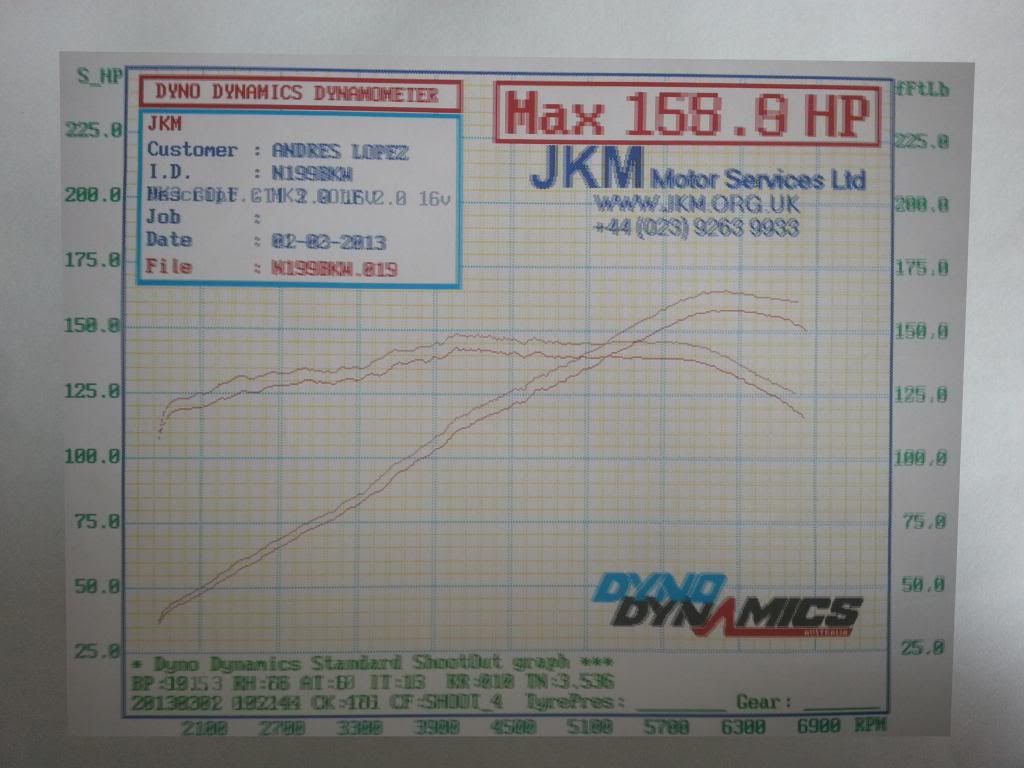

Here's a comparison between the 159hp and the 165hp run.
Identical path, just lower numbers, hence why I suspect it's calibration related.

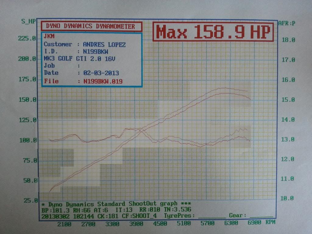

Your previous test was on a low pressure day and your recent test was on a high pressure day.
Although the high presure should be better for the engine, the dyno will correct for the high pressure and reduce your figures.
It is a correction like this that may explain the difference.
Other things would be to compare the AFR plots from the two days if you got those printouts aswell.  NVM if you didn't as not everywhere gives those out as standard.

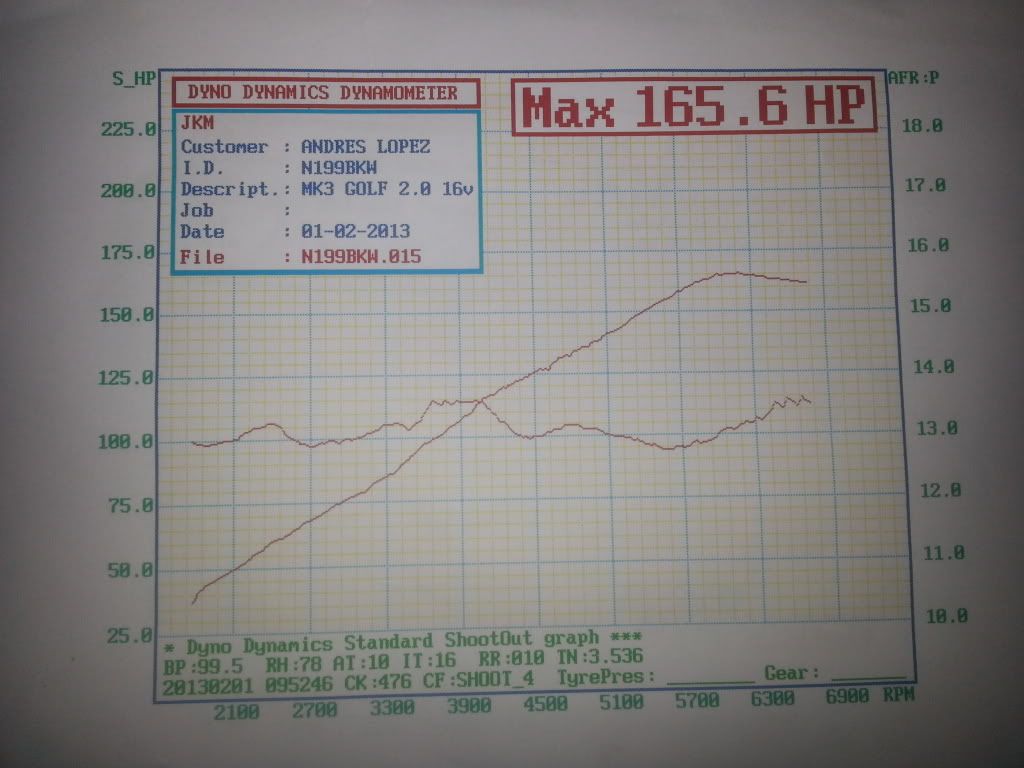

Here's the AFR. Fainter line is the 165hp run.
Figures at the bottom are from 158hp run, here's the 165hp run's figures.

I think I've found out the reason why I may be down on power.....
Intermediate pipe rusted and has broken off the decat pipe! Jesus christ it's loud, embarrassingly loud. Had to drive down the high street with a polity "sorry" grin on my face. I think It's heard within 10 miles  :shocked: :embarrassed:
Going to go for a new system, ofcourse. Another spenditure I wasn't looking forward to!
