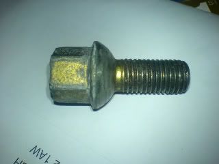

Just bought some 5mm spacers off ebay, £10 for all 4.  Just gotta get some wheel bolts now, ive got a right mis-match in there at the moment, there long enough but most have the incorrect taper which is hardly ideal... have got a post up in the wanted section for these if anyone has any

what seating you after, ball or tapered?

I think its radialised i need, is that the same as ball?  I need a set like this:
