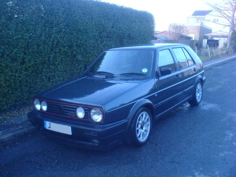

Here's the old girl. Phone camera pic hence 'the darkness' :grin:
