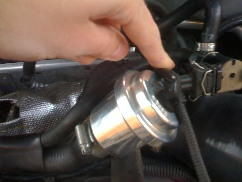

A few of you may have noticed that I've been whinging like a little girl over the past month or so, due to some missing ponies under the bonnet!!
Well, I'm pretty sure (fingers crossed) that I may have now sorted it.  The problem was with the vacuum hose that goes on the top part of the Forge DV.  What happened, was that when my new KO3-S went on with the new SFS TIP, the TIP pushed up & stretched the vac. hose which was strangling the flow.  I forgot to take a 'before' picture, but I've pulled the pipe down with my finger so you can see what was happening.  (I also reversed my Forge as per advice from Midland VW):-

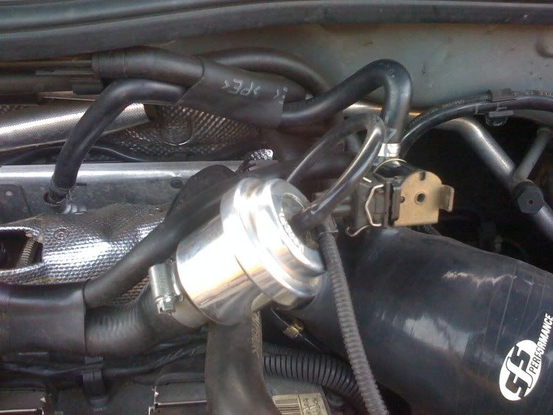

This was the finished article (**EDIT** With the new longer piece of silicon):-
I'm quite chuffed, actually - The old girl seems to be pulling how she should, again!!  :cool:  It's got the :evil: factor again!!   :smiley:
The reverse DV makes a funny little 'ping' now, though!!   :grin:

Thing is, though, is it the reverse DV that's sorted it, or is it the vac hose??  Don't want to try the DV the other way around in case I disrupt things!!!
only one way to find out though really  :undecided:
