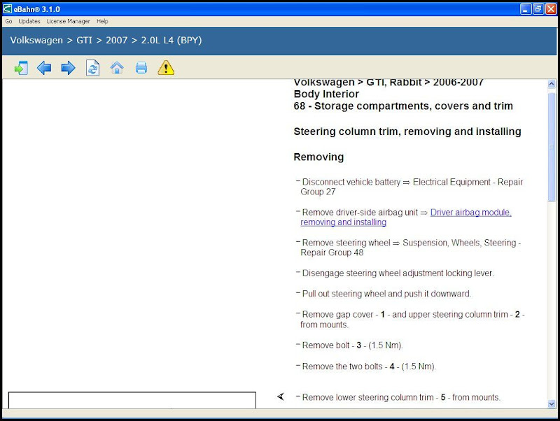

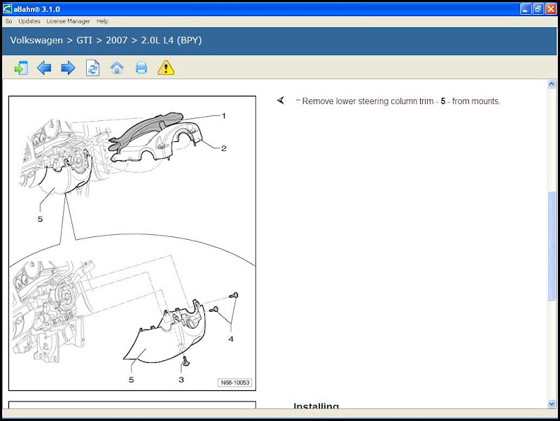

You may be right about pulling it out but the Bentely Manual says you need to, see attached.
Thoough there does not look like any screws in to the top part. If you figure out how to eliminate the scraping sound please post as I have a similar problem.

I fitted cruise a few weeks ago and removing the wheel was no problem, as yes the bottom cowl is screwed behind the wheel. Top cowl unclips and is hinged at the back.
You do need a spline socket to undo the main wheel bolt if you go that far.

If you turn the steering wheel 90 degrees to the left and right, it usually exposes the screws on the face "boss" - you just need to poke a long screwdriver through the open spokes of the steering wheel.  I can't confirm exactly if the Golf 5 does behave like this though.  :smiley:
