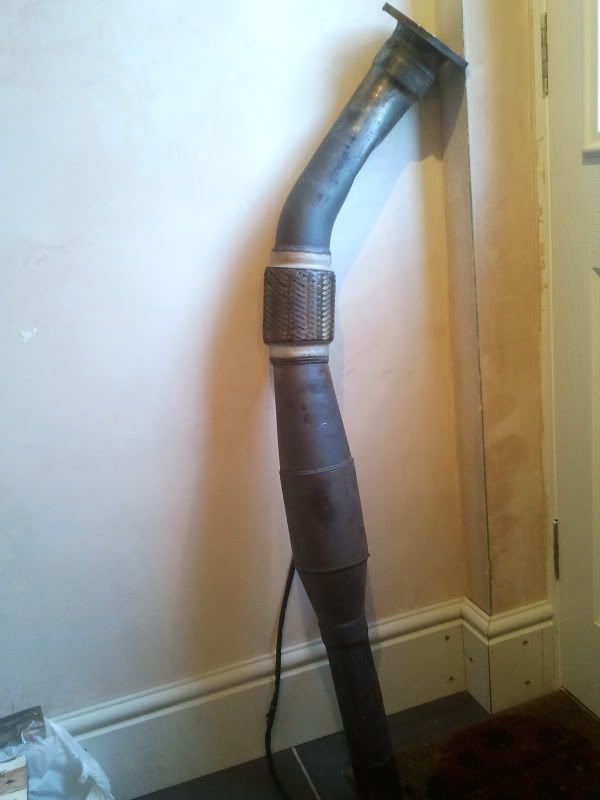

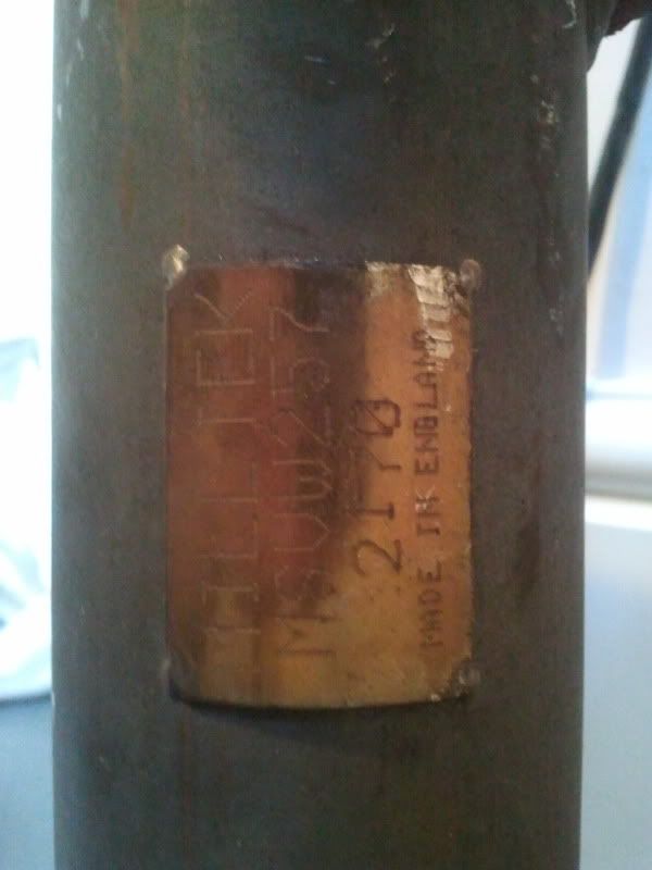

Managed to find myself a genuine Miltek downpipe/sports cat for £150 so bought that, fed up trying to get a bent MOT.
All did not go well though, had it fitted and it was blowing from the flexi join :(
Got in contact with the bloke who sold it to me asking for half the cost to repair it and he gave it to me which I was very surprised about.
So it was off to Advanced Automotive to have a new flexi welded in and it runs like a dream now.

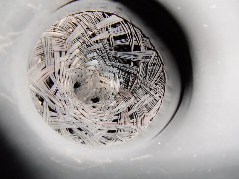

While I had the decat off I had a good look over it and I was shocked at the condition of the inside of it
The flexi on the inside has come apart...
Should see if this has restricted the flow when I pop over to JKM for a rolling road day on Saturday, it will be the first time it's been tested since the FMIC and sports cat have been fitted
