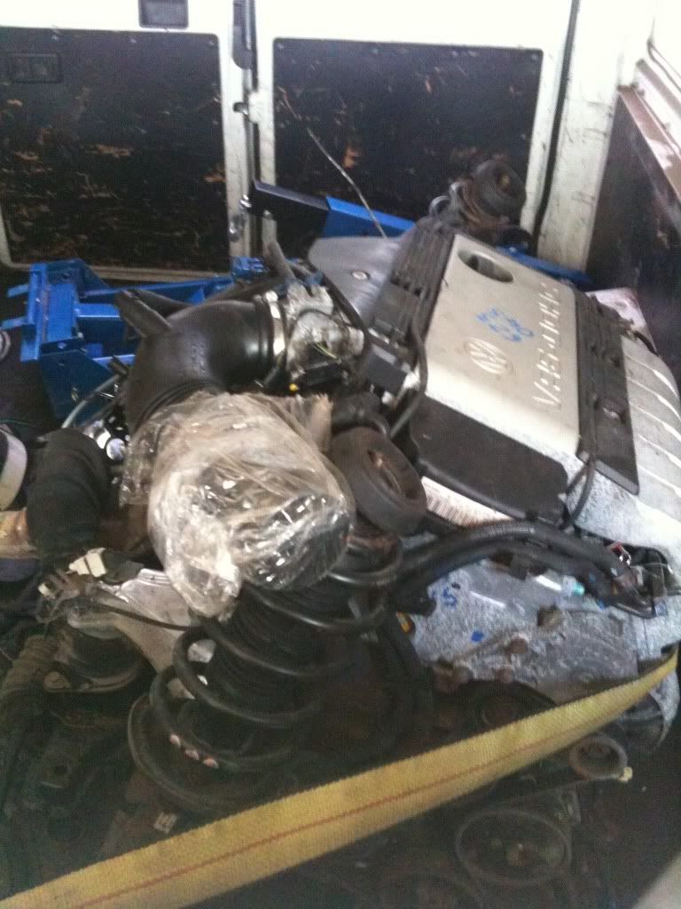

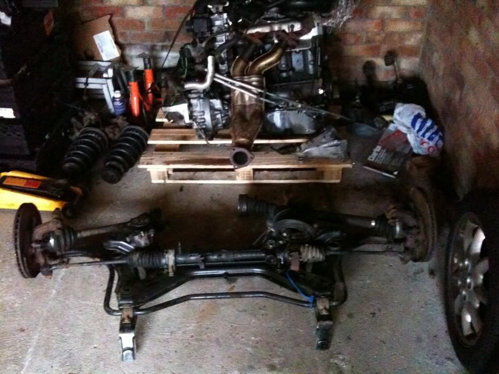

So i now have a VR6 to put into my 8v.
This isnt going to be a quick conversion, as i plan to do it right first time.
I have bought a OBD1 Coilpack VR6 with 62k on the clocks.
Today i removed the suspension, brake calipers, and disconnected the driveshafts and engine mounts and draged the subframe and rack off. As i dont require any of this.
Plan is to now change the clutch, chains, aux belt, filters, plugs, leads etc.
As its a 2.8 OBD1 i plan to get a Rado 2.9 inlet manifold and throttle body, for a bit of extra power, i want the TB painted black, and the inlet chromed.
Going to paint the engine and box oem factory colours, and get the front cross member powerdercoated black.
I will be ordering a 6branch manifold, decat, and having a full stainless 2.5inch exhaust from the decat backwards. To allow for further engine mods.
Air filter wise i plan a BMC inclosed jobbie.
For the bay i just plan to clean it up, polish it, and hide as many wires as possible.

Having an arse of a day, not so much an update thread.
Turns out that i have noticed the rocker cover is broken, think it must of got broken when moving the engine, and it has snapped off where a pipe from the air intake fixes too the rocker cover. So thats another thing to add to the list.
