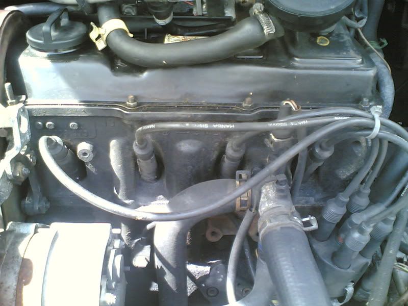

right cheers guys.......er.....where is the blue temp sensor?

Offline Mew
  • Posts: 3,589
Re: whats wrong with my motor!?
« Reply #4 on: 18 May 2008, 10:43 »
Fits in the top of the coolant pipe flange coming out the front of the head. There will be a blue one and a black one in series.

right ive got a white plug type one and then next to that is a little like 12mm nut type one i have pics of them but no idea how to put them on here!

Offline Mew
  • Posts: 3,589
« Reply #6 on: 18 May 2008, 11:56 »
Ahhh with it being an 87 it may well have the earlier type then. I think they're more expensive too  :lipsrsealed:

« Reply #7 on: 18 May 2008, 11:59 »
That look familiar?

« Reply #8 on: 18 May 2008, 12:08 »
yes is it the little nut you can see on the top of the coolant pipe?
how the hell did you get that picture that fast?!!!
