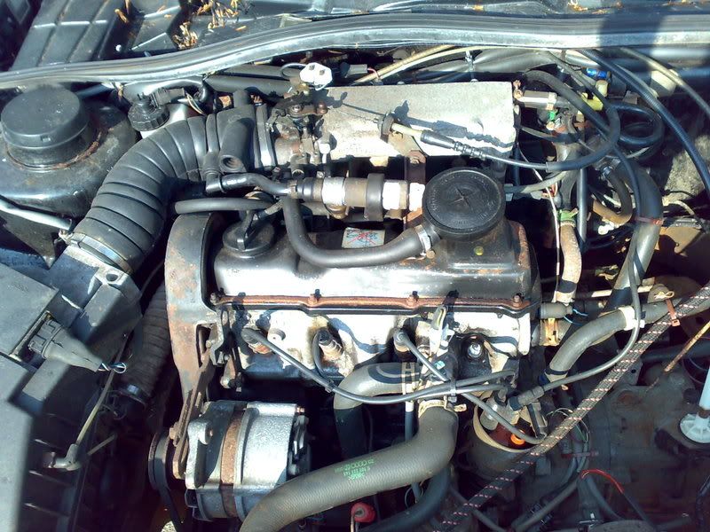

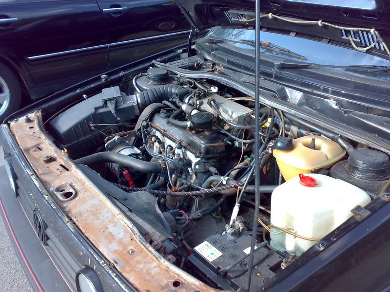

altho im good with mechanics im not that great with these ARB or didgfant or k-jet things or what they mean?
i have a pic of the engine bay if it helps...

« Reply #3 on: 09 May 2008, 13:44 »
I am sorry that is a digi so you may be able to do the 2 litre valver swap, still not sure about the wiring though as I think that changed on a 91  :smiley:. K-jetronic was the system fitted to the early 8V's and all MK2 16V the digifant engine management system was fitted to later MK2 8V's and I think MK3 GTI's.

« Reply #9 on: 10 May 2008, 10:26 »
That is a Digi Engine running a CE1 fusebox (pre-1990) therefore the later 2L 16V engines etc will not work without alot, and I mean a lot, of re-wiring. Its only the 1990 models that are direct fit as they run CE2 Electrics (same as all the later models like the 2L 16V, VR6 etc)
The best thing you could do with yours is fit the 2E or 3A Engine from a MK3 Golf GTI 8V or an Audi 80 2.0E. These are 8V bottom ends and all you'd need to do is a straight swap and change your dizzy. It'll not give you huge amounts of more power but it will increase you torque and thats more important.
