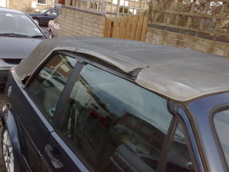

The roof is shot and looks like it has been for a while. Got to get a new one and looks like it needs new headlining too unless I can clean it up. Best quote so far £550.

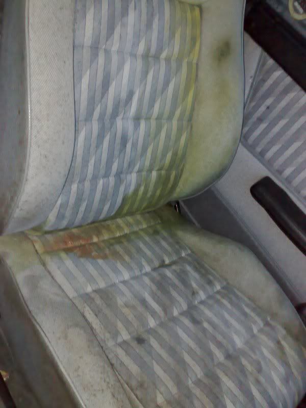

The seats are covered in green growth, mildew and rusty water stains. I do want to try and clean these before I replace them because they still have great padding in, and they are pretty comfy.

If your removing the hood yourself, or have a garage to store it in so you can remove it, I would try scrubbing the liner first with some cleaner.. check all the hoods "stuffing" no dampness and its all in the right places and then get the hood fitted, unless your doing that yourself? Looksee here for a how to.. http://www.golfgtiforum.co.uk/index.php?topic=34662.0
Looksee here for a new hood.. http://www.golfgtiforum.co.uk/index.php?topic=73524.0

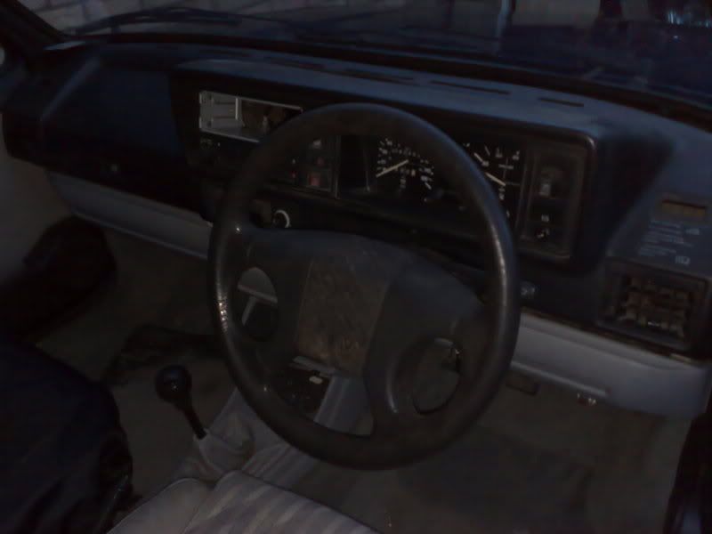

It also looks, from your pics, that your lower dash is a different colour to the top half?

I have thought about trying to fit the roof myself, but after finding the fitting instructions, all 31 pages of PDF file, I think I'll get someone to fit it. There's a guy near where I live that has been recomended to me and apparantlly he's really good. I was thinking about removing the outer skin and cleaning first before I get the new hood fitted. That place looks like a good one to get it from, but I have found someone else who will come out and fit just the outer skin for £280.

The bottom of my dash is a different colour. Should it not be? The rest of the interior is grey so I just figured it was normal.

I also gave the interior and the headlining a good clean yesterday which made the world of difference. Loads of windowcleaner and a nailbrush brought everything up lovely. Lots of spiders had taken up residence in the hood frame and made it their hatchery.

lower dash is correct if its a later model i think from 1990 h i think or could be 1991 as they came with different colour bottoms to the top! it looks a really good fine fella even with the messy interior! plus you can pick up another interior for quite a cheap price! who are you going to get your hood done by as i see your fairly local to northants and i could do with getting my outer skin done for my cab cheers jeff

After a weekend of cleaning, the interior is looking much better. I do need the top door trim though. the driver side one is really bent for some reason. Seats will come up with a carpet cleaner.
I was going to get my hood done by a local guy in Bedford who runs a garage and does upholstery but now I'm thinking to save money, I'm going to do it myself. I got the guide from the Golf MK1 owners site and it seems pretty comprehensive.
