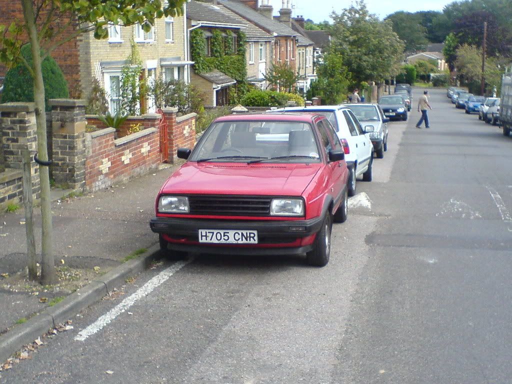

Offline vwjack
  • Posts: 667
Re: mk2 grill swap
« Reply #9 on: 21 March 2008, 15:40 »
i did the same and when i did i didnt want to drive the car any more!
hope these pics help! because if i saw this photo before i did it i would of not done it.
