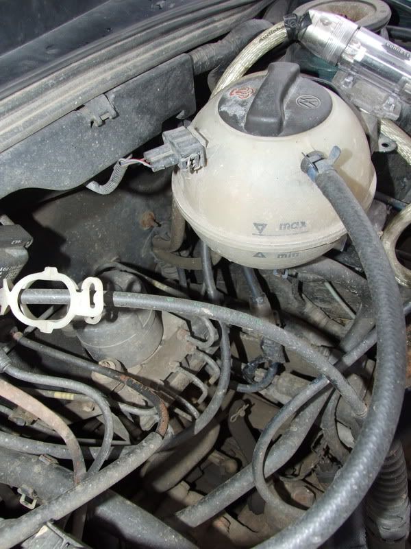

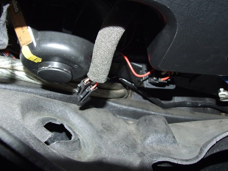

just under the water bottle you can see the cables going through
passenger side footwell there pull the cover down and its just there
then you run off behind side trim and up under sill protector.
hope that helps
