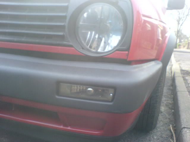

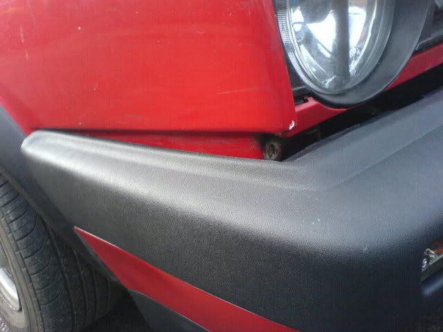

there is a inch or so gap from my bumper and my grille and other parts. what can i do?

Either your plastic side clips are snapped, the big 17mm bolt bumper fixings are loose, or the overall bumper bracket is badly rusted.
Get it jacked up and have a look. Search for "Big Bumper" to get loads of info on what to unscrew etc.

When I was putting my bolts back in, the rear ones needed weight pushing up on the bumper to bring the thread close enough to the bolt to get it to "grip". If just the front one's were tight, it would make the bumper hang like yours - perhaps thats whats wrong??

one side of my rear bumper was like that
2 washers later
straight as an arrow  :cool:

and nope,  i didnt use longer bolts - and i " stuck " the washers onto the bumper brackets to raise them up
