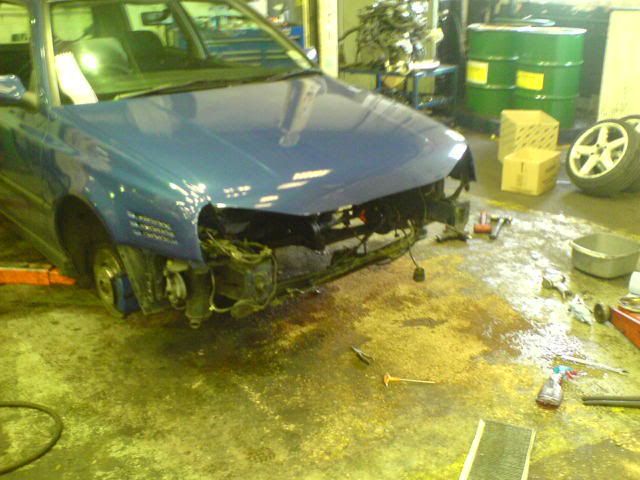

Then i bought the coillies and put them on and flushed the wiper and badge

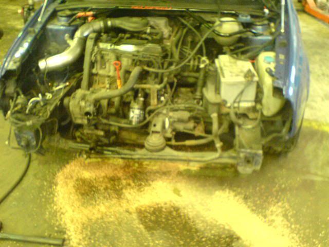

it went a lot lower than in the pic but i aint took no pics of it because a week later i took the engine out lol
then engine out

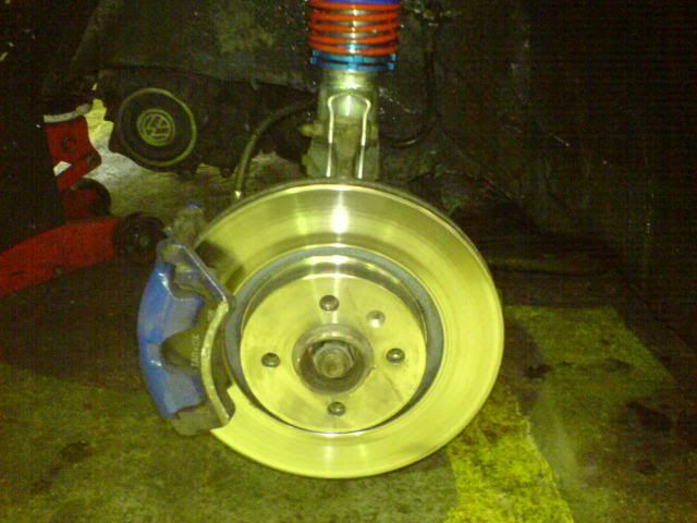

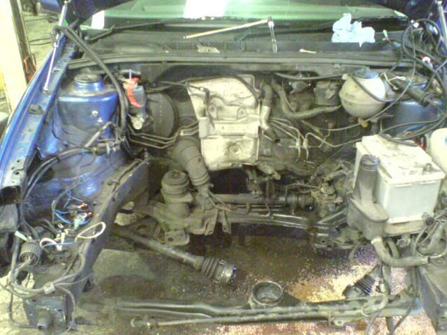

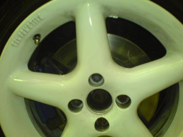

whilst i was taking the engine out i replaced the front brakes(256mm) for the 280mm setup off the g60/seat ibiza cupra.
with the 16" on they filled it just nice lol
these will be upgraded again when i get some more money.

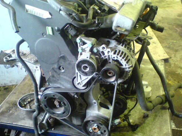

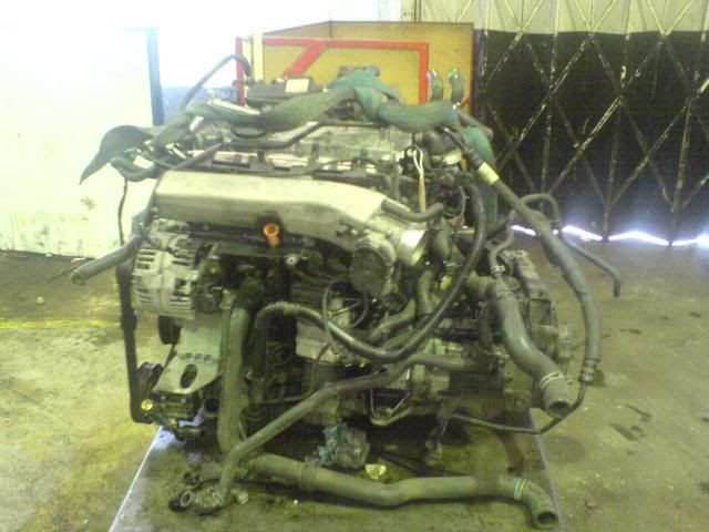

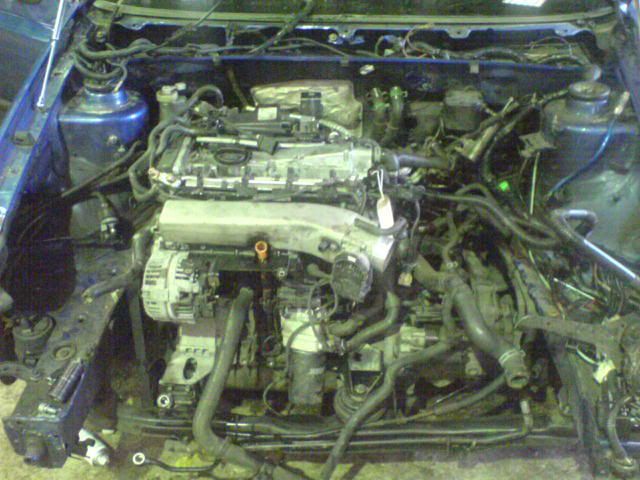

my donar engine from a seat ibiza cupra 2001 with k03s turbo fitted
also fitted new cambelt,tensioner and waterpump whilst the engine was out .

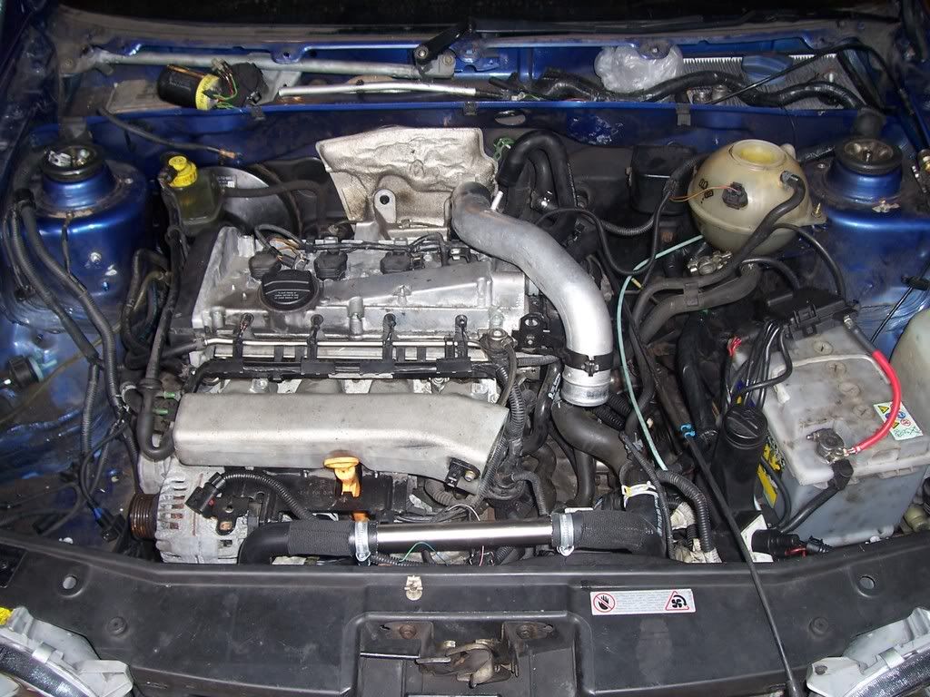

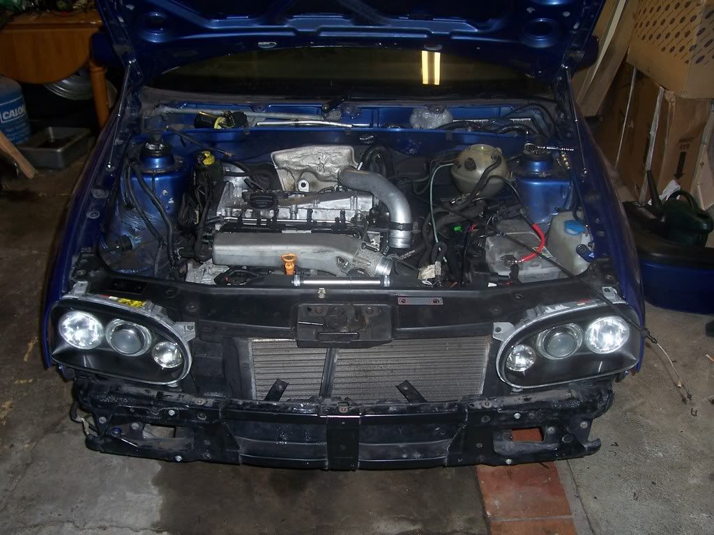

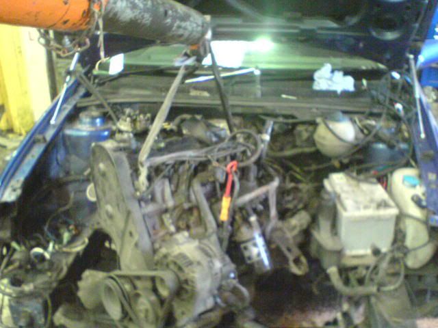

engine all built up and ready to go in
engine in and fits brilliant using all the original mounts off the ibiza
will put up more pics tomorrow .hope you like

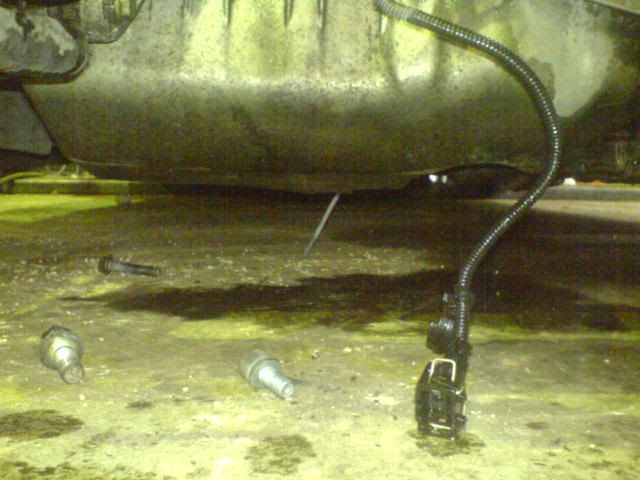

this is how low the sump is to the floor -scary

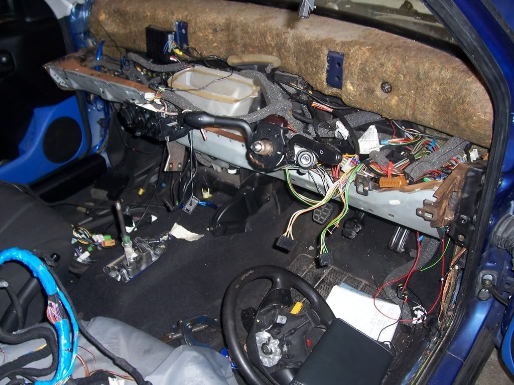

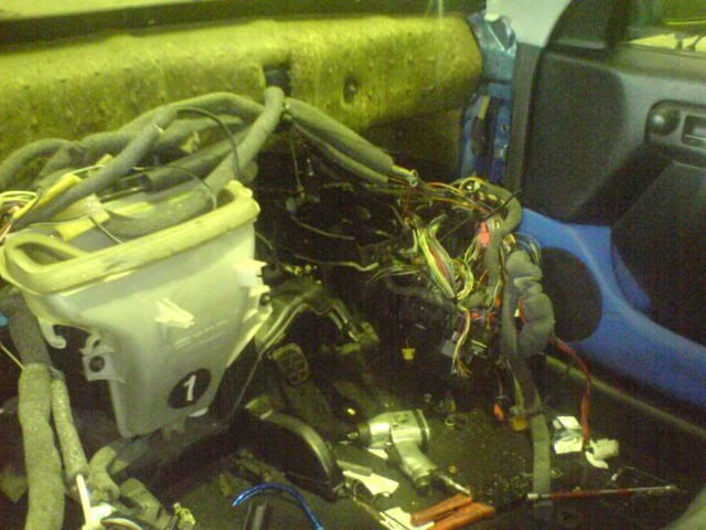

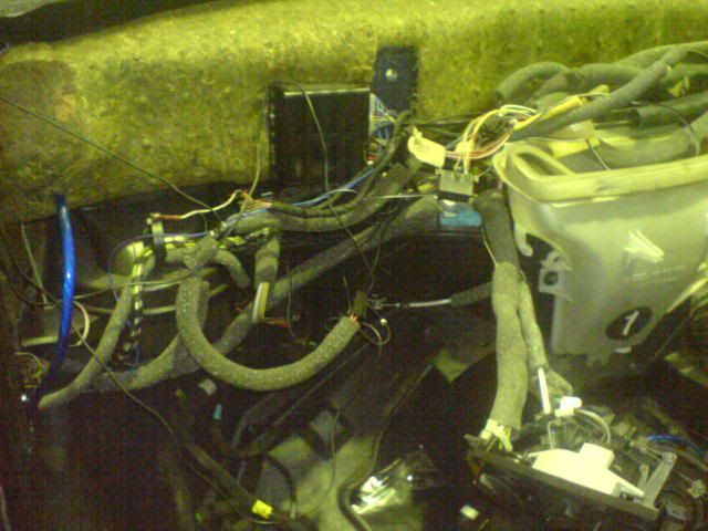

some random pics off the dash out

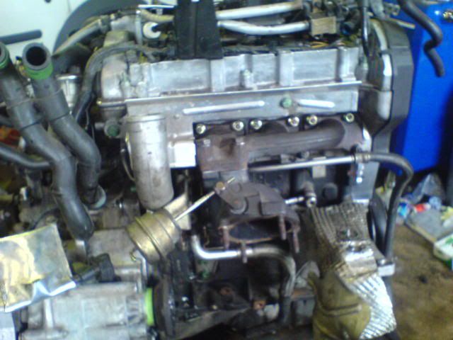

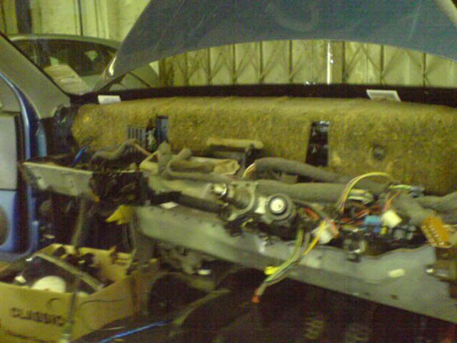

some more pics off front built up

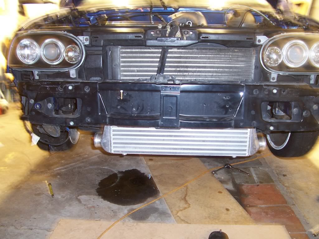

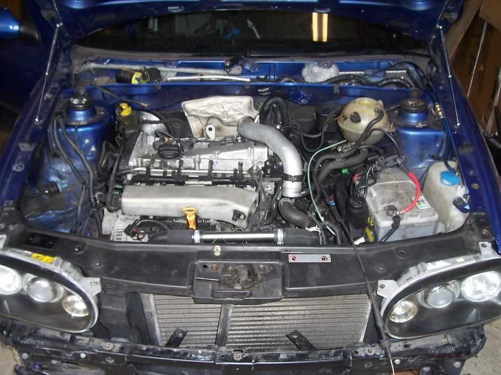

intercooler on
