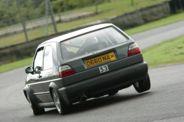

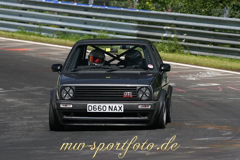

I have a D reg Mk2 16v which I built up with the following, trying to keep to a reasonable budget, but using my experience of racing and race cars to build something that would be quick, fun and reliable. Anyway, here's whats on it;
Bespoke multipoint rollcage (very btcc!)
- Cages off the shelf are OK, but I wanted more protection and it was either bespoke or add tubes to a Sparco or OMP and the cost difference was negligable.
Bembo 4-pot calipers
- Used up front from Seat Ibiza Cupra R with backets to fit the std hubs.
- Standard Seat Ibiza discs
- Racing pads
- AP 550 brake fluid
- Later 16v master cylinder
- Braided lines from master cylinder, throughout car
- Brake bias valve, located in car
Engine
- Standard 1.8 16v with 130k on the clock
- MOCAL Oil Cooler - mounted alongside radiator
- Aeroquip braided hoses
- New radiator
- New head gasket
- Samco water hoses
- Late model inlet madifold
- OMP exhaust
- 9a 2.0 engine in bits waiting to go in...
Gearbox
- 020 box
- Quaif Limited Slip Diff
- Lower final drive
- All new gear linkages
- Standard clutch
FK Coilovers with Koni inserts
- Got these cheap, second hand and thought 'give em a go...' they have been great for the money.
Anti-roll bars
- Nuspeed front
- Eibach rear
- For no other reason than I got given the rear one, new and for free and there was no stock in the country of the fronts..
Lower strut brace
- Sits between lower wishbones
Corbeau Evolution Seats
- Luke 5-point harnesses
Wheels/Tyres
- Road: 17" white 5 spokes with Yokohama A539's
- These look great on the road, but are crap on the track!
- Track: 15" Compomotive 5 spokes with either Toyo 888's or Dunlop Slicks
- Awesome!
Other bits;
Big bumpers
Front brake cooling ducts where fog lights used to be
G60 arches
Carbon fibre door cards
Carbon floor panels to make the floor flat and raise slightly front footwells
Water temp, Oil temp and Oil pressure guages mounted where the stereo should go
Perspex rear window and rear side windows
Remote boot release
Removable OMP steering wheel
Fibreglass bonnet
Single headlamp grille
Rear M3 style lights
Crystal indicators front and side
De-locked 'cult society' boot plinth
Cystal headlamps
Front windows are electric as I use it on the road and couldn't fit manual winders because of the cage
Peltor rally intercom
New wheel bearings
New Powerflex bushes everywhere!
Solid front engine mount
Lifeline 'plumbed in' fire extinguisher
Race spec ignition cut-off switch
I have done 2000 miles on circuit in the car this year, including a 4 day trip the the 'Ring. I drive it to circuits in the UK, but it did get trailered to Germany...  It has not broken once, or even missed a beat. Quite incredible really as it gets very, very abused! It is a great car and I can't wait to get the 2.0 in it! Let me know if you want any more info, pictures, etc.
Cheers,
Martin
