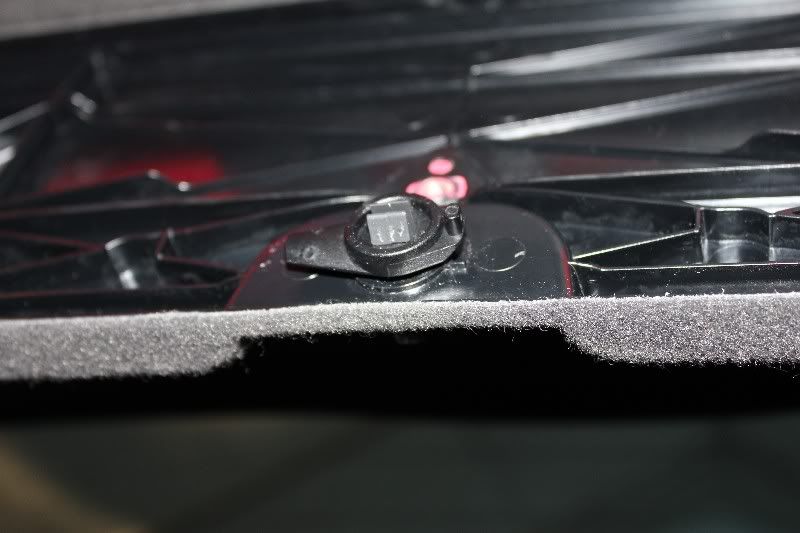

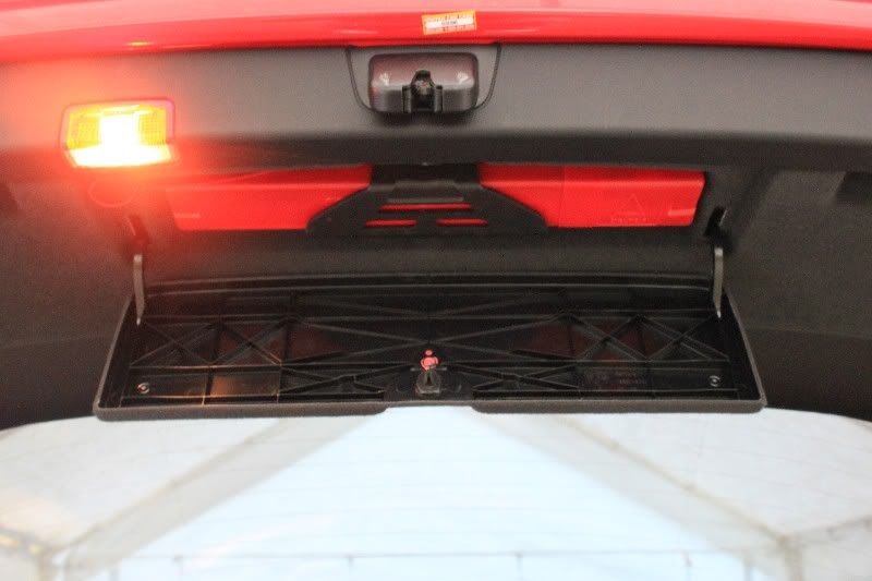

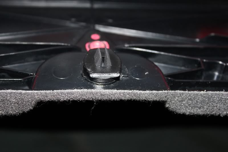

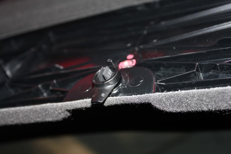

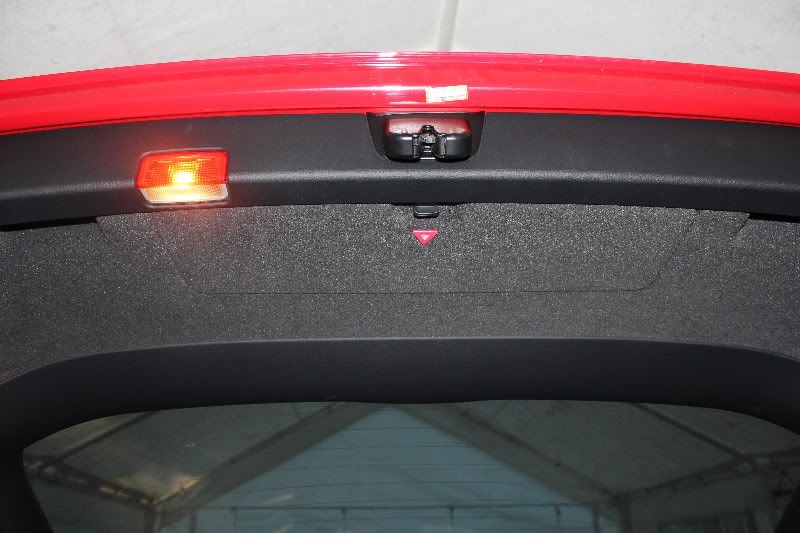

So two jobs completed today, fixed 65'' TV, replaced capacitors on motherboard, so happy for that to be done! :) and fixed rear hatch door that holds the Emergency triangle;
There is a plastic latch that is known for breaking over time, so quick pick up from Local Audi Dealer yesterday ($10!) for part and onto replacing it today :)
The issue!
The New part!
off comes the old part!
Compare old and new parts
You just push on the new part
All done
End result
Also took picture of RS4 Wheels with center installed, going to get tires installed later this week. In two minds if to keep or sell....... but I really do like the finish on them and Dave did an outstanding job.
