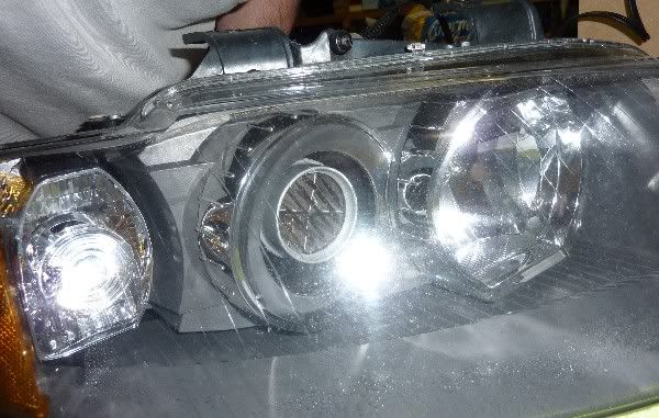

Here is pictures of headlight before any work.

And how the headlight units from the front

STEP 7. Time to remove the amber inserts without drilling or damaging the headlight units, so you can if you want reuse the amber inserts in the future.
Using a small flat head screwdriver for this part, you need to put tape on the end of the screwdriver, to make sure you don't scratch anything inside the headlight unit.
Now with screwdriver in your hand, put you hand through where the main bulb/lens was (make sure you don't scratch anything) . Work the flathead screwdriver gently prying underneath the amber insert as outlined in the below picture. The amber insert is held in by a tiny tab at the bottom and at the top.  Gently keep working it and eventually it will pop out and you can shimmy it out with the screwdriver. Again, take your time and be careful not to scratch up the inside.
NOTE: You can if you like unscrew the silver light ring, to make it easier to get inside the headlight unit, but I found I didn't need too.
Now you have the bottom part of the insert out of the tab, you will find it hard to get the top out by only pulling on the bottom area. This is when you now remove you hand and screwdriver and put the screwdriver through the side indicator hole at the back of the headlight unit as below picture. You can then push on the back of the amber insert which will then pop out the top tab. You now have the insert free. You can guide the amber insert down to the bottom of the unit.  Now you can put your hand back in through the main blub/lens area and using your fingers pick up the amber insert and remove it from the headlight unit back through the main blub/lens hole.
Following pictures show above actions
Screwdriver pushing on back of amber insert from side indicator hole
Amber insert free now, gently moving to the bottom of the headlight unit, so can remove
hand back in through the main blub/lens area and with your fingers pick up insert and remove.
Pulling amber insert out through main blub/lens hole.
And the headlight unit without amber insert - looking good :)
And the amber insert on the table after removed from headlight unit :)
