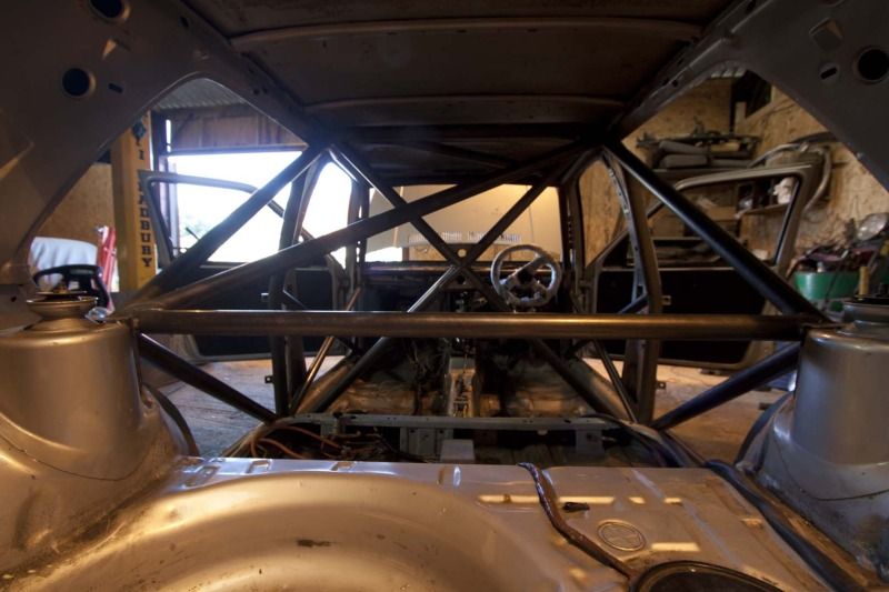

A bit more about the cage:
Front strut pick-ups:
A-bars and door cross bars, showing the sill mounting:
Top of the front section:
Rear struts:
View when taken from behind:
That tubing specification in full:

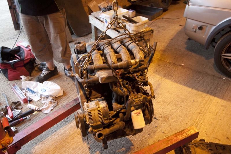

Mike, who's coming out to drive this as his first 'ring experience is a VW technician and so got on with the important servicing of the ABF:
Replaced cambelt, tensioner, waterpump, thermostat, rocker gasket, sparkplugs, new crank sensor, crank seal at flywheel end.
Fitted lightened flywheel, gearbox, built up other misc bits on engine.  It's now ready to be fitted and will go in once I've done the driver's seat mount and slapped some primer on the tubes in the engine bay.
Engine built up:
Skinny flywheel - 9kg down to around 6kg:
Engine and gearbox waiting to go back in:
